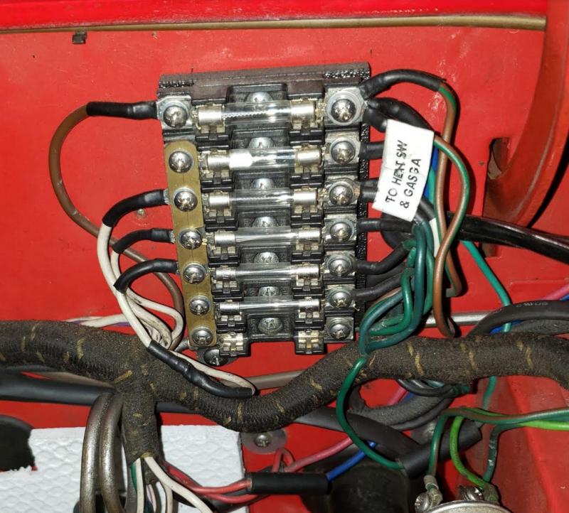

steveg
The Charlie Hart fuse block is a good thing to get started with - if he still makes them. It separates out the ganged green wires at the bottom of the regular fuse block. Uses the same mounting screws as the stock block.
hartcg:atmsn.com

Patrick67BJ8
hartcg:atmsn.com
I purchased one of his fuse blocks for my BJ8. It has six fuses. The difference between early and late big Healeys is the green wires are on the opposite side.
Patrick67BJ8
Interesting BJ8 version has 6 fuses while the older model has 7.
Addendum: Charlie Hart via email above, informs me he does still sell them. Needs to know for which model.
He also includes a wiring diagram with what size fuse goes with what circuit.
