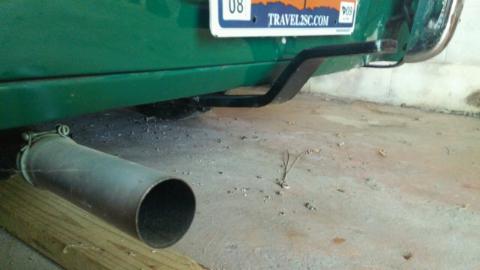

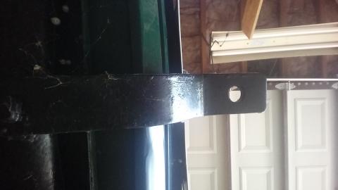

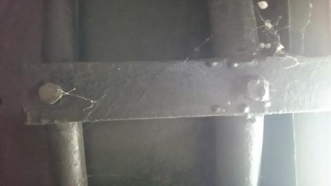

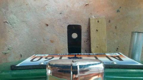

John, My '59 TR3A had a trailer hitch when I got it in 1980. The story was a PO used it to tow their sailboat. It looks custom made and possibly a period kit. Note the nice body-matching curve to get some extra height for the hitch. Two bolts at the bottom plus some welds for attaching. Was going to take it off to look 'stock', but a pal said why not leave it for extra protection so it remains. Its actually pretty solid; the ball would have to be removed to get to the spare.
I took some shots today with my cell phone. Jeff TR3 Hitch_1.jpgTR3 Hitch_2.jpgTR3 Hitch_3.jpgTR3 Hitch_4.jpg

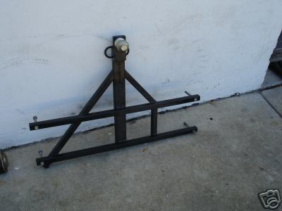

hitch593A.jpg I have a NOS Valley hitch for TR4-6 but the rear support requires two holes in the rear bumper bar (which 3s don't have). So whatever you do has to be supported at the rear, not just bolted to the rear frame members. Maybe you might tie into the bumper supports but be careful of tongue weight.
Here is a photo of a home made hitch from a 59 3A that I found online a few years ago.
