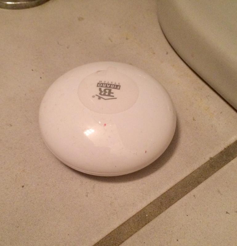

I installed small round moisture detectors like this
in all the bathrooms, laundry room, kitchen and the BASEMENT by the water heater.

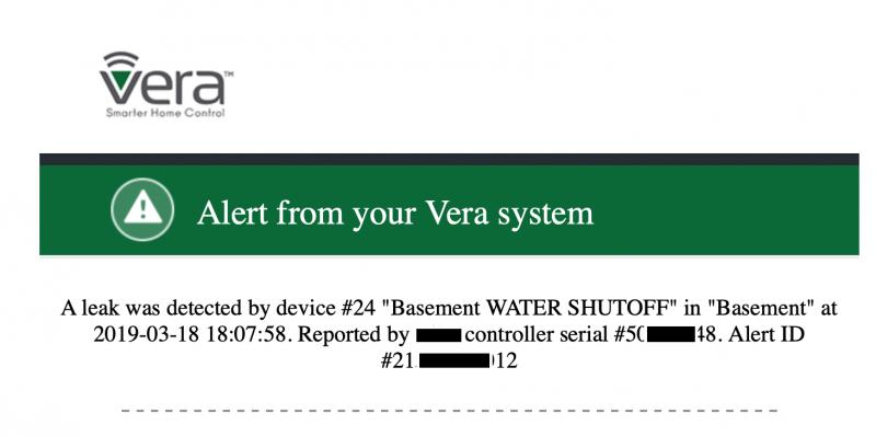

Yesterday evening I was getting ready to leave when I received this text message:

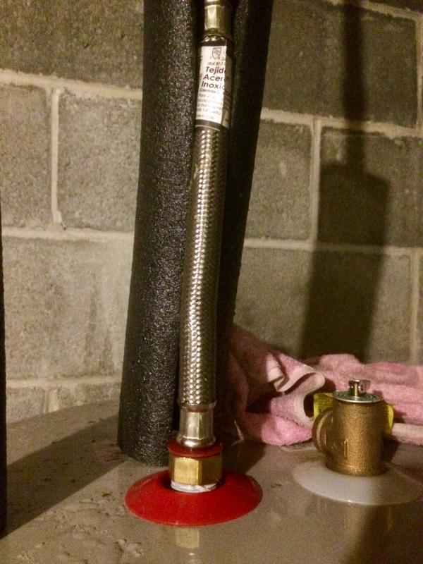

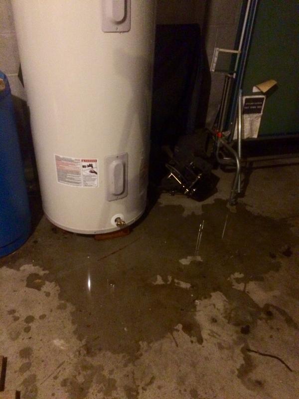

As soon as I got the message my wife called to say she also got the "alert" and wanted to know what was going on. I went into the basement and found that my water heater supply line had started to leak and was streaming out of the top of the water heater. Once it started to pool onto the floor the moisture sensor notified the z-waved control box and the water to the house was automatically shut off in seconds avoiding major damage and sent me a text message to let me know.

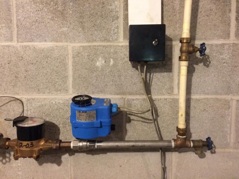

This is the water shutoff valve and control box I installed:

Is this system something you bought off the shelf or did you make it from various components?
I bought the z-wave control box; it’s called Vera (but there are others). I also bought the moisture sensors.
Then I sourced the water shut off valve and installed it just after the water meter and wired it to a relay that’s hooked up to a z-wave receptacle. When the moisture sensor signals the control box, the control box turns on the z-wave receptacle which energizes the 120v shut off valve.
Since I built mine there are ready-made devices that will shut off the water but I don’t think it will notify you.
