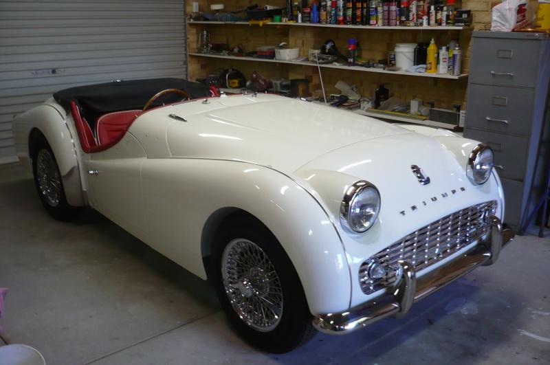

    P1010258.jpgDavid
    I got new buckets from Moss and I couldn't make them fit and they were very flimsy so I worked on the old originals, much better.
