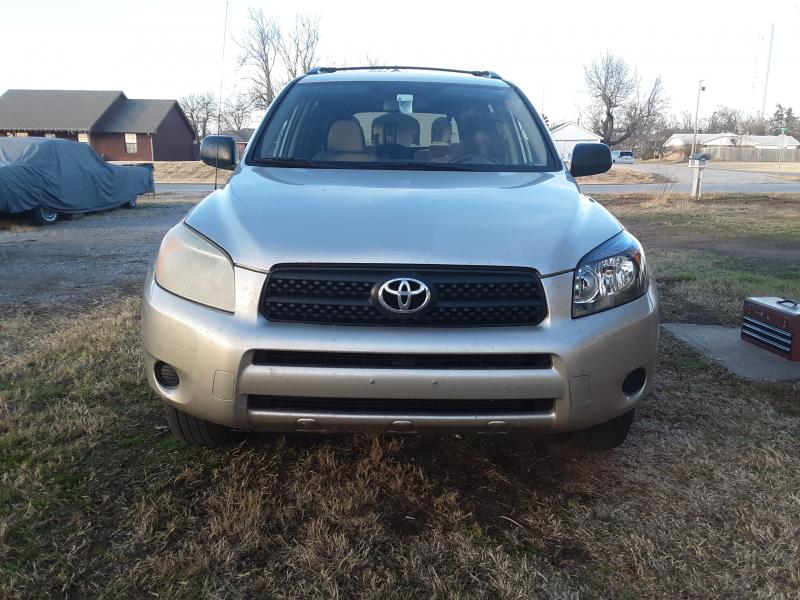

The headlight assemblies in my Toyota need replacing so I ordered some new ones off of Amazon. They arrived and today being a nice day, I decided to replace them this afternoon. Hah, I over estimated my capabilities and under estimated the Toyota engineers sheer evilness. To replace the headlight assembly, something that has four bolts attaching it, you must loosen the front bumper and remove two of the fender bolts to give you enough wiggle room to wriggle the assembly out. You must then must fight, and sweat, and bleed to remove the old headlight assembly and then bleed, and sweat, and fight to install the new one. Once that is done you can replace the two fender bolts and secure the bumper. I managed to get the driver's side replaced before the sun went down, I'll do the passenger side tomorrow. 20181215_165021.jpg

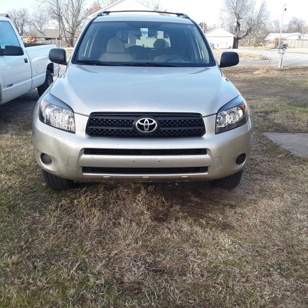

I got the passenger side taken care of today. They were way beyond polishing, the plastic was beginning to crack. New cars are a PITA to mess with in so many ways. If I ever do this again I'll just remove the front bumper and grill, it would have made access a little easier. Here's the final product:
