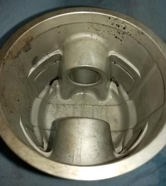

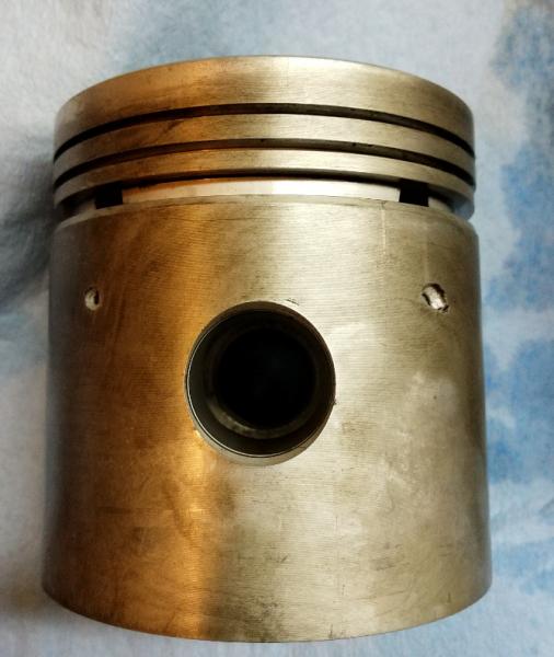

I do have a somewhat related question. The County pistons have 4 very rough holes below the oil ring, that appear to be covered from inside the piston. Does anyone know the reason for these holes? The look of them makes me question the quality of the pistons, and wonder if they will last long term. I have only rebuilt a few different engines, but have not seen this anywhere else.
CJD
Those holes are likely not blocked. They go up to the back of the oil ring, so that oil which is scraped from the cylinder by the ring is transferred lower down the piston skirt for lubrication. Sometimes they will just go inside the skirt to reduce/increase the amount of oil on the cylinder wall. Those pistons are just fine.
J
Joel M
That makes sense, although I don't understand why the holes look like they have been busted out. What kind of manufacturing method is that? I guess one that is cheaper than just drilling a clean hole.
