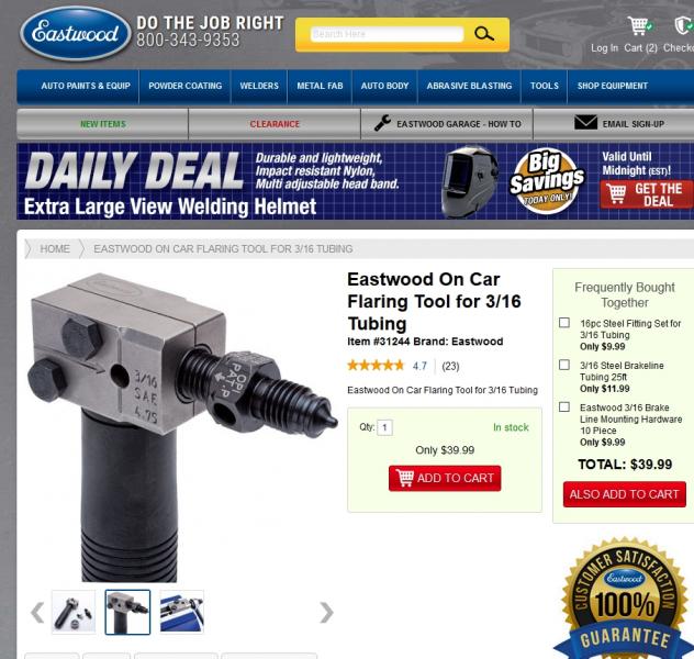

For sure keep us posted on any info you get back from FedHills. Especially if you can get a flaring tool from them or they tell you where to get one. I have the Eastwood tool that makes pretty much all modern flares, and had planned on just finding the flare option on that tool that most closely resembles the flare that comes off of a TR line. I've had good luck doing similar in the past, but if there's a "real" correct flare tool available, I want it.

Take a look at FedHills flaring tool rental: https://store.fedhillusa.com/toolrental.aspx

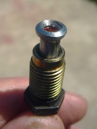

I have two flaring tools: the Ridgid 345 Double flaring tool, which can make doubles or bubbles or square backed bubbles.
Later on I acquired the Eastwood tool, which IMO makes better flares more easily. The final flare appears to be the same as a MOPROD Universal flare (as Moss sells). These flares seal in either double or bubble applications:
I'm not too exited over making an exact original flare as much as making one that seals. If it seals, it's good.
