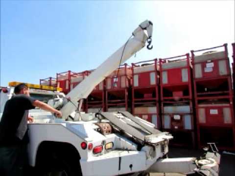

Add a boom to the rear of your motor home, then you don't have to worry about pulling it on a dolly.
waltesefalcon
A tow truck boom, you could also make a little money on the side using it as such.
waltesefalcon
Yes, just a poor one.

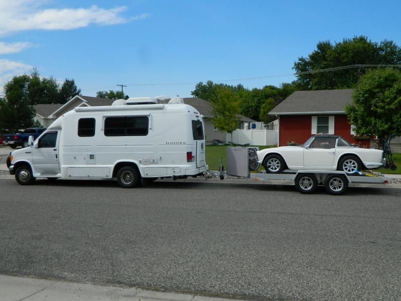

My TR4 preforming "toad" duties. If you continue to read the RV forums you will find towing backwards on a dolly is not recommended.
