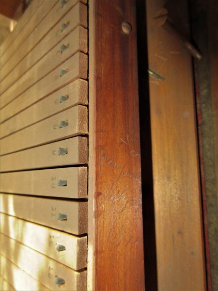

Yesterday I even found the workman's signature on the back of the keyboard.
"T. Campbell July 27 1874"
Sure hope I can get it all back together eventually.

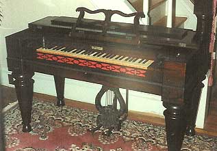

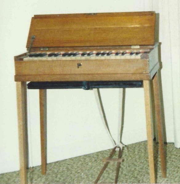

Three forms of melodeon.
Early 1800s:
"Piano style", closer to 1860:
"Traveling" melodeon, often used by itinerant teachers and preachers:
Those are much simpler to restore than the larger parlor organs like mine.

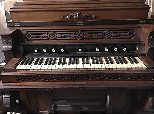

This is not ours as ours is presently in storage, but identical to it. It's an Estay of the late 1800s. All I had to do was restore the bellows valves, it plays very well, the wife used to play it around Christmas time, when we lived in our big old Victorian house. Kinda miss that. PJ
