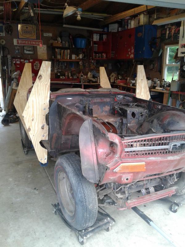

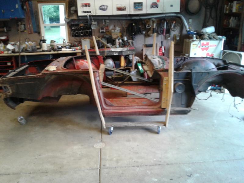

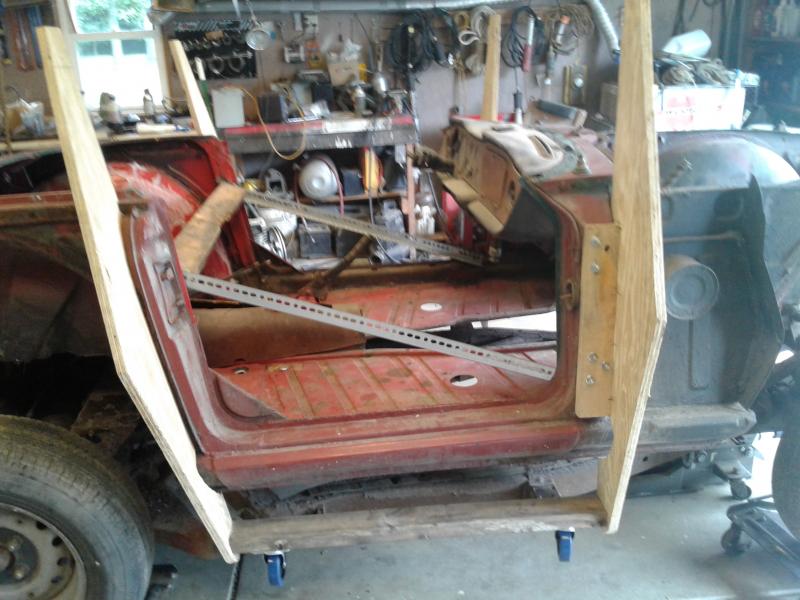

Have you seen my version of the wooden rotisserie that I am using on my TR250 project? It has worked out quite well. I used this in conjunction with steel reinforced door openings and cross bracing.
Let me know and I can post a video for you to take a look at if you are interested.

M_Pied_Lourd
Here you go. Let me know if you are interested and I'll post a link to the original plans that we modified slightly.

Scot1966
image.jpgI made basically the same a Tush. Worked great - I could flip it by myself.
Scot1966
Dollies on the bottom are next level genius. I would have drug it around my garage and drive for months before that occurred to me.
Oh yes, I forgot to mention I added those ! They came in handy, with swivels on the front - as I wheeled it in and out of the garage countless times for sand blasting.

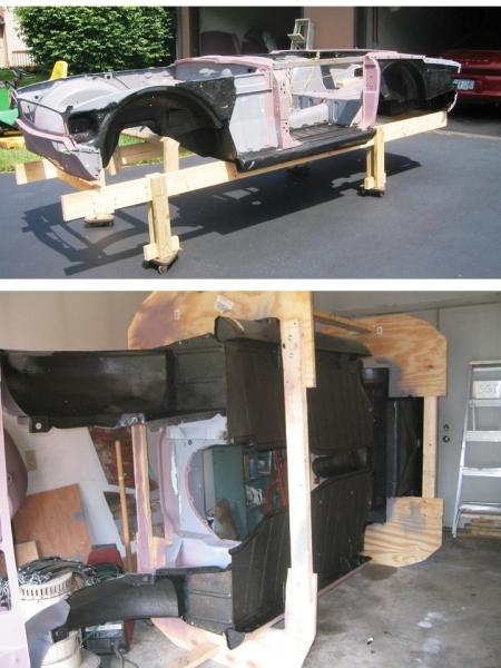

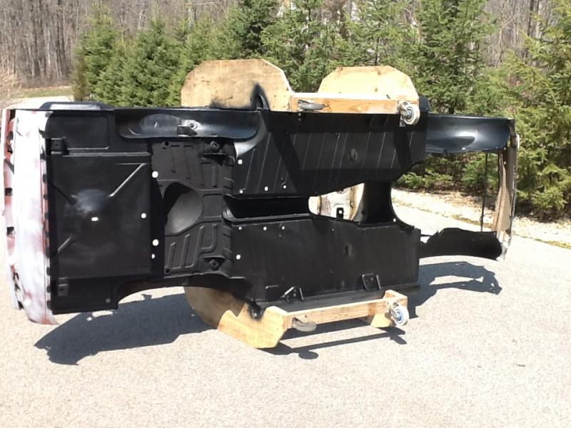

Gliderman8
Here are the two jigs I made when restoring my 6 a couple of years ago. One is the rotisserie and the other jig was very useful in moving the body around; the wheels were most helpful .

Ok got my 4 basic boards cut out. Did anyone compensate for the angle of the B post or just let it ride? Thinking of cutting out some spacers to make it square to the body and floor.
I also don't see how the front board is attached to the 2x4 that is attached to the A post. I bought 4 lag bolts and was going to go into the sides of the 2x4s.
