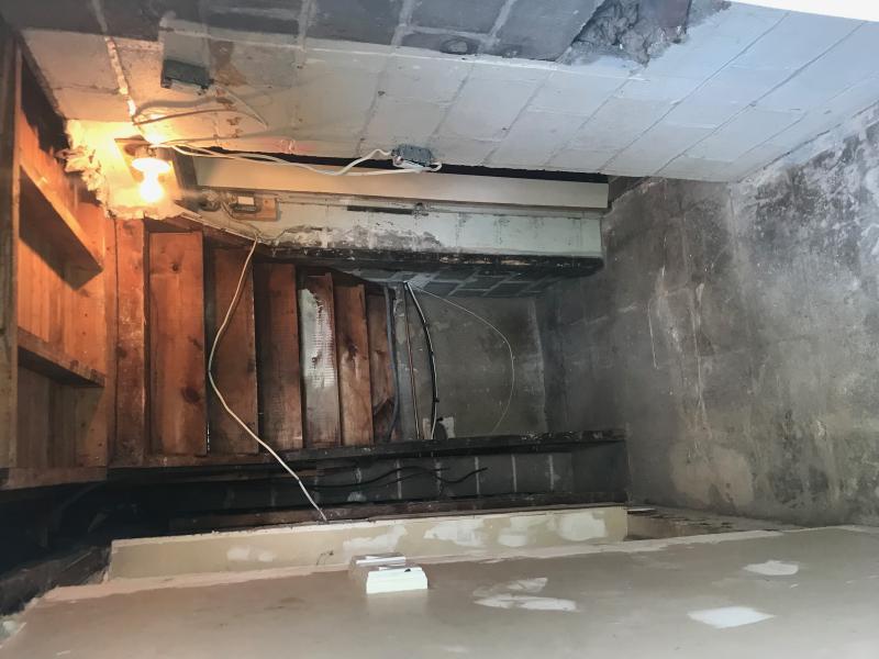

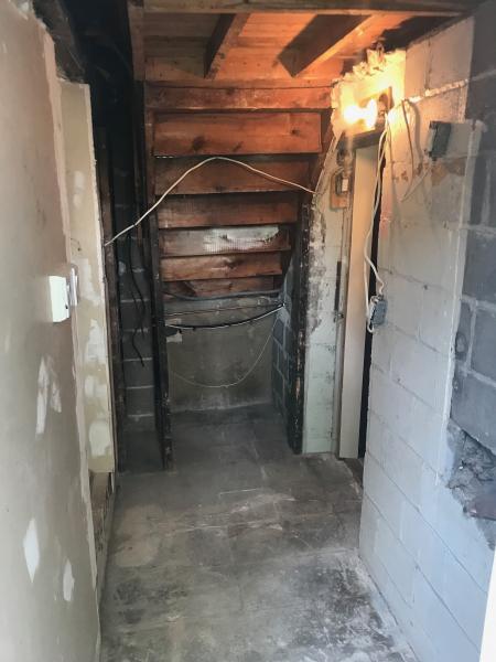

So, I figured if I post my pictures it will keep me on track to finish in a timely manner - because that is working so well with my car restorations :rolleyes: - at any rate, this is the breezeway in question. To orient yourself, when the house was built in 1940 the house (on the right) was separate from the garage on the left. In 1947 the owner built an apartment over the garage. So, the back of the stairs in view is the stairs up to the apartment. (the entry is on the front of the house) I was standing just outside the door to the backyard to take this pic.
The key bit of information is that literally nothing is level or square. I can't get over how crooked the stairs are - and the floor slopes away from the house as per the original landscaping, so much time is spent looking for points of reference.
never a dull moment that's for sure!

Address that wiring FIRST! Anchor the boxes and switch(es) to make things occupy known places. Dress Romex up and over, I'd drill holes in those 2x6 rafters to route it, so you can put your "breezeway" in with knowing where the wires run even if you have to get longer wiring.. Then ceiling sheetrock. Forget that it is not square, build to the angles. I'd provision for the lighting to be in the overhead, centered. I'd sacrifice passage width and use 2x4 strips anchored to the CB wall, two pieces thick to flush mount the electrical boxes and hang the sheetrock.

Tomorrow's job, The wiring is absolutely bonkers. the power goes through the breezeway into the garage - back into the breezeway through the dumbest possible routing including a buried junction box. Have the studs up so that we can put it in to code - and consolidate. Also, the pipes froze a few years ago so we have to add an outlet for the heating wires that wrap around the pipes - and, on a separate circuit the small electric heater that will go in the space. belt and braces.
