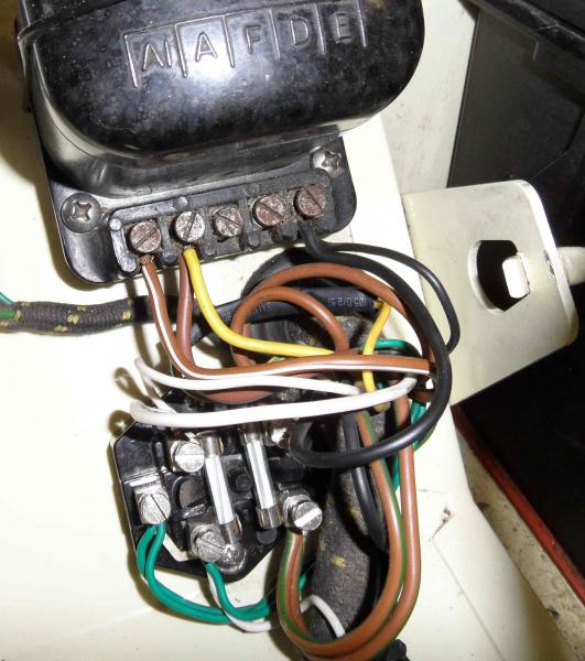

    This photo was taken as I was parting the car out after the wreck, so not everything is connected. But hopefully you can see my shunt (the small coil of black wire) and the original harness wires.
    I don't have a photo of the alternator wiring on that car, but here is my current TR3. The green wire is 10 AWG to my current 45 amp alternator.

    That would be a start; but for it to work properly you also need to have the ignition, lights and so on connected to the alternator side of the ammeter. That way, it monitors current being drawn from (discharge) or going into (charge) the battery.
    Kind of like this (tho your alternator doesn't use the 'IG' input)

    Glenn, perhaps you should link to the photo you are asking about. I don't recall ever posting a photo showing a yellow wire, unless perhaps I linked to someone else's photo for some reason.
    The original wire to the generator output would have been yellow, but the color codes on my current TR3 have long ago faded to a more or less uniform brown (or black where the outer cloth covering has fallen off). And the generator wire on my previous TR3A was both thoroughly toasted (no longer yellow), and discarded back in 1984 before I even owned a camera.
    In the original wiring scheme, the brown wire ran from the solenoid to the ammeter, then a brown/white wire from the ammeter to terminal A on the control box. The control box internally links A to A1, then A1 runs to the ignition and headlight switches (to power all of the loads connected to those two switches, which was all of the car except the horns, starter and OD solenoid if present).
    In the photo above, I have modified the control box to be nothing more than a convenient tie point, to join several heavy wires together. All of the internal components have been removed, and a heavy jumper soldered underneath to bridge the A, A1 and F terminals together. The original NW and NU wires were moved over by one terminal, and there are two new brown wires that feed my headlight circuit breakers (hidden inside the car) and additional fuse box (which in turn feeds the electric radiator fan relay, brake light relays and dash power outlet).

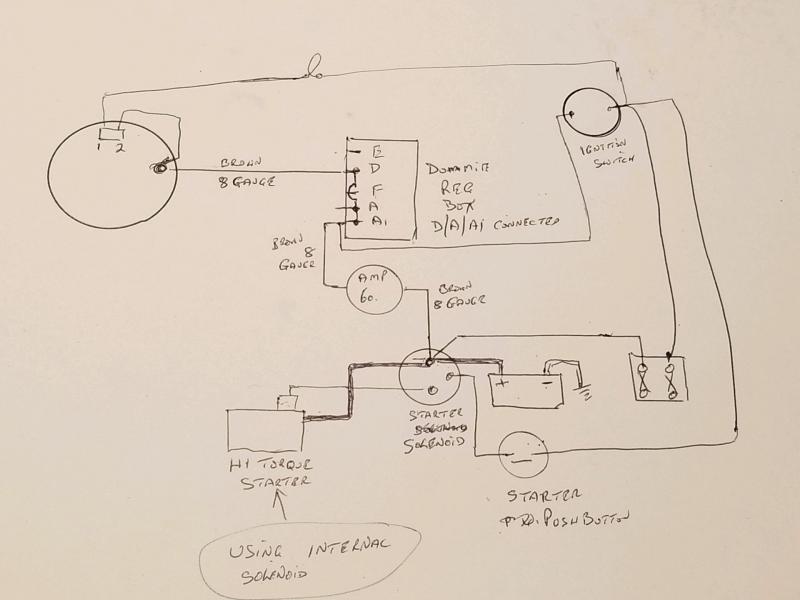

    It may be the diagram I had posted.
    In the process of wiring it up but have not tested it yet. May use my tractor that has the same type of alternator to prove the concept.

    I have your sketch but hesitated to follow it since the post I saw with it asked for comments and I wasn't sure it would work. It is a bit like Randall's drawing that he posted later. Here is the photo I attributed to Randall, although it may not be from him.

    Like you I am no electrical engineer that is why I posted my proposed diagram. Wanted to get some input from the forum. I do plan to do a mock-up of it using my tractor as a test subject as that is a diesel, has the same alternator and I can easily change stuff around.
    If everything works out I will tape my new wired into the harness that came with the car.
    David

    Not my photo, Glenn; but it's quite possible the yellow wire is from the alternator.
    David, your diagram looks OK to me. I have only one very minor quibble with it: Looping the 'sense' input (terminal 2) back to the output right at the alternator like that will slightly reduce alternator performance. Not likely to ever be an issue with the way most people use their TRs; but on a diesel farm tractor, you might want to configure it as shown in the diagram I posted above, for faster battery recharging (eg after a hard start in cold weather).
    All wire has some resistance, as does the ammeter. The resistance is quite small, something like .001 ohms per foot of 10 AWG and another .001 or .002 ohms for the ammeter. Perhaps .010 ohms total (possibly more on your tractor, depending on how far the battery and ammeter are from the alternator and each other). But with 60 amps of battery charging going on, that represents a voltage drop of 60 times .01 or 0.6 volts; which is enough to 'fool' the voltage regulator into limiting how much current the alternator puts out. It will still charge the battery, but at a lower rate than what the alternator is capable of producing.
    Lots of people have it configured as you've shown (it's popular with the hot rod crowd and you can even buy a regulator that makes the connection internally) and they'll tell you it works "fine". Quite true, I'm just saying it could work a small amount better. GM thought so too, which is why they provided that input (not all alternators have it).

    Thank you for the confirmation on my drawing.
