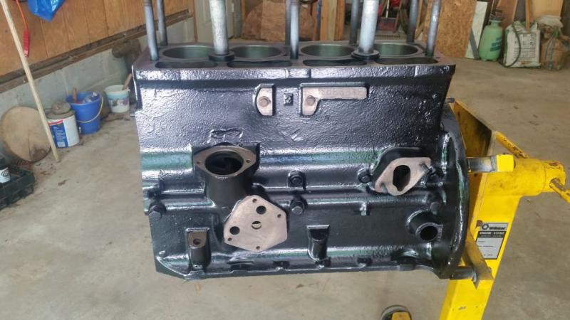

Remember if you remove the head but do not plan on removing the liners you need to clamp the liners to prevent them moving.
David
