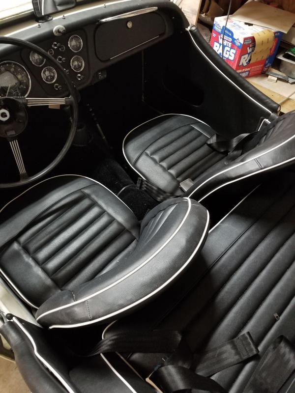

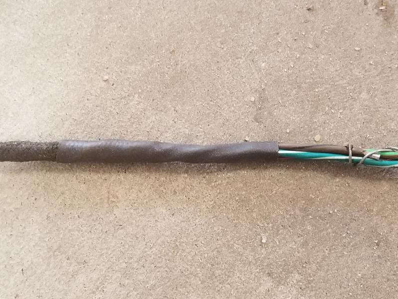

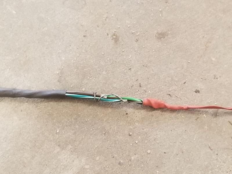

    Having got all the carpet installed I decided I could safely tighten down the steering wheel and install the indicator/horn assembly.
    I threaded a piece of locking wire down through the tube in the center of the steering column and attached it to the 4 wires that needed to be threaded through the tube. I had removed 3 of the bullet connectors to reduce the size of the bundle. Put some electrical tape over the join and started pulling. Went well for the first few inches then hung up. Wen I checked the top end I found the fabric/cotton sleeve had bunched up and was stopping any further progress. I pulled it back out slid the sleeve back into position. (Noticed that the wires are twisted not straight). Then slid a bit of heat shrink sleeve over the 4 wires and the first 1" of the sleeve. I also put a bit at the very beginning of the bundle where the pull wire joined to the wires.
    It pulled through with out a hitch. So smooth that I managed it single handed.
    I now have working indicators and horn.
    Did a 20 mile run to check things out. Everything seems to be working well.
    David
