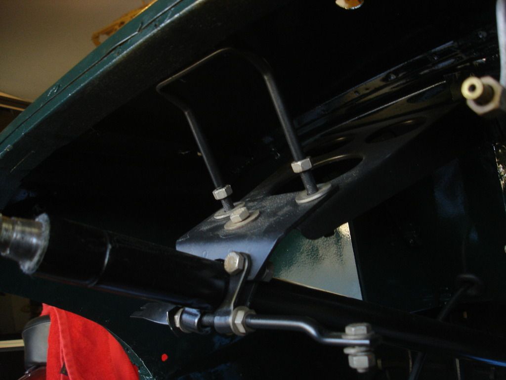

During a walk around, I'll point out some of the features. This is the rear exhaust mount.

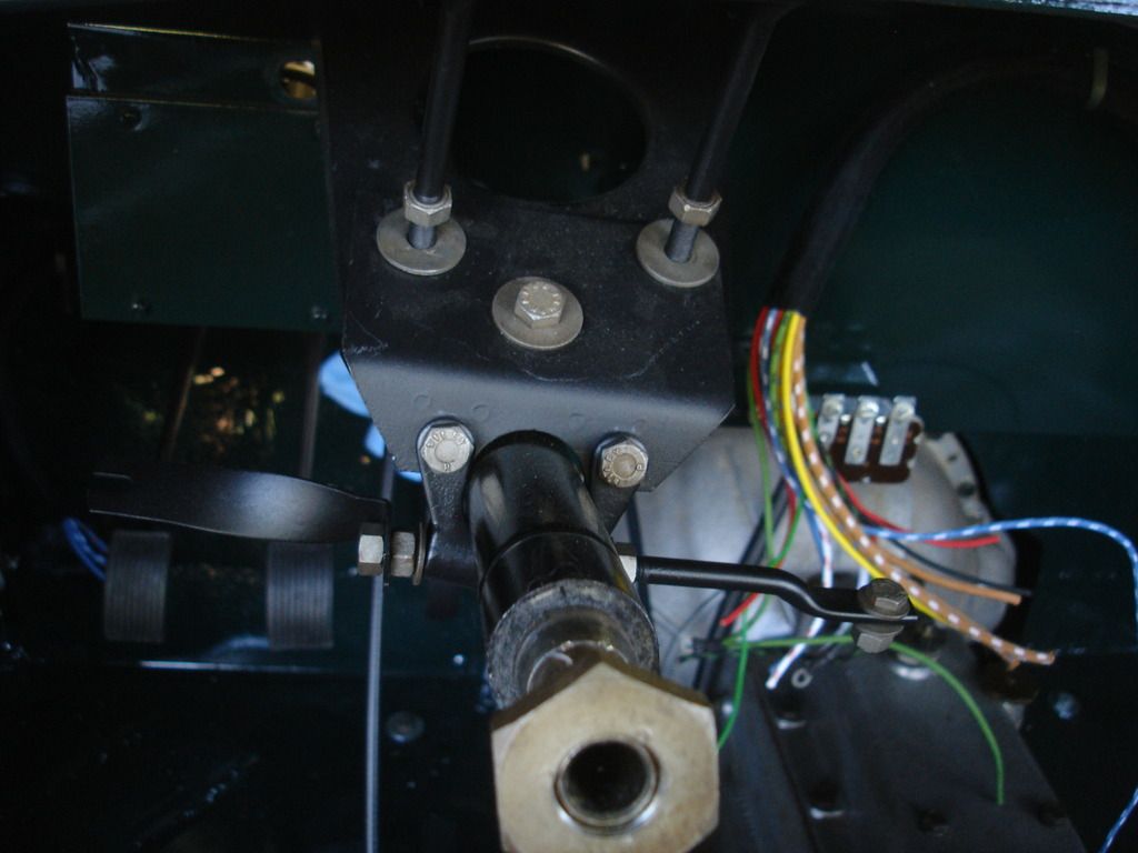

This is the bracket on the right that accepts the rear axle brake hose.

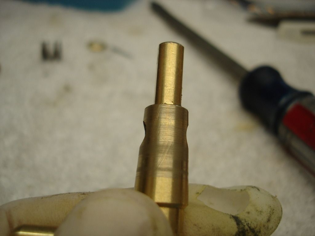

Also, note that the bronze bushings in the small end come too small for the trunnion pin. After pressing them in they MUST be reamed to final size.

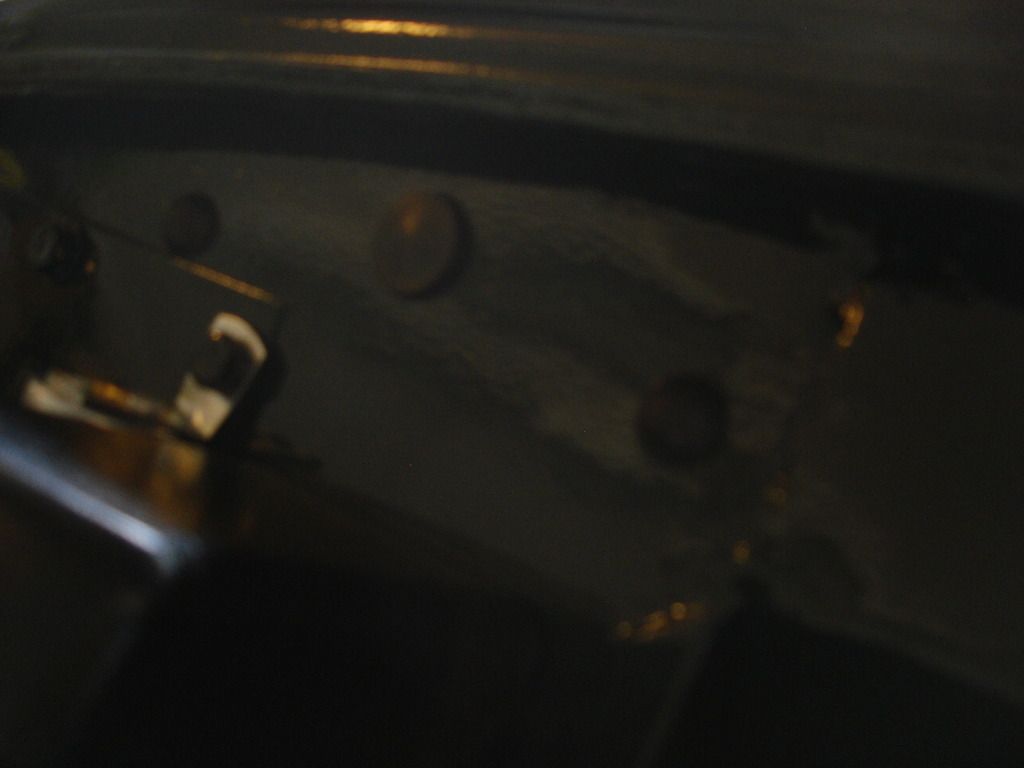

The back plate is held with 2 "set screws" at the bottom, and 2 long bolts at the top, which also go through the steering arm. Note, these are the early Lockheed, dual cylinder front brakes. Most will never be unfortunate enough to have to deal with this many parts! The locking tabs have to be bowed a bit...even the originals looked like that.
You can tell night set. One day I'll have to get a new camera with a flash!?!. This just shows the steering arm held by the upper 2 long bolts with nylock nuts.
That's where I stopped last night. I'll have more progress to report by the end of the week...
