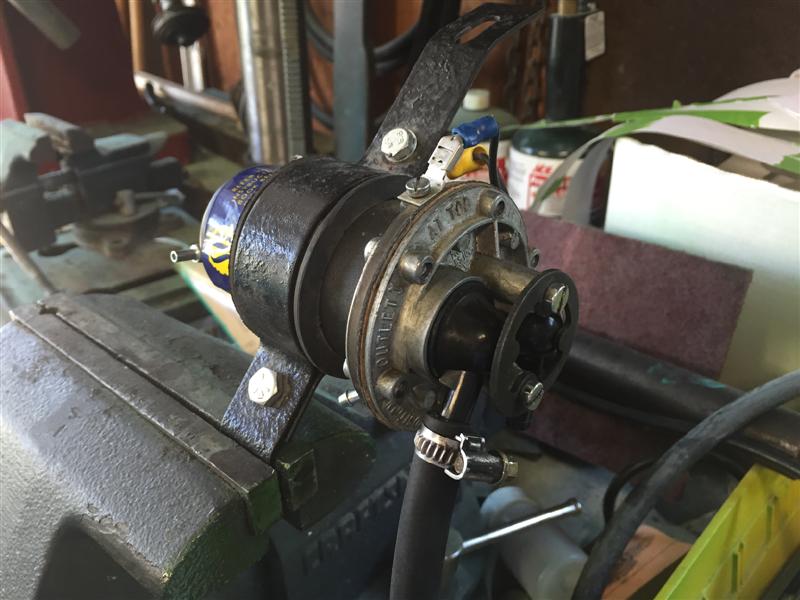

After wiring up my rebuilt (by me) SU fuel pump, AUF305 from a 73 Midget it refuses to run. I tested it on the battery before installation after I rebuilt it and it worked without hesitation. Everything looks good, but no joy...should I send it off for a rebuild or buy a new solid state SU? If I send it off, who should I send it to?

I removed it from the car and connected it directly to the battery, no joy.

The pump is corrosion free and looks like it did after I rebuilt it about a year ago. I'll take it apart and see what's going on, but I really want a trouble free SU pump and if all else fails I'll send it off or buy a new electronic ($$$$ shudder) one.

I opened up the pump this morning and everything looks new...connected it to the battery and it ran like a champ. The points are clean, but I'm considering the electronic conversion. Anyone have a good source stateside?

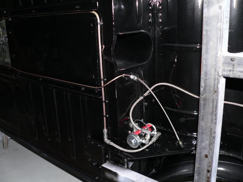

I bought this SU new and it developed a leak shortly after it was in use. That was a year and a half ago. Since I had a supposedly reliable Facet pump I procrastinated doing anything with the SU and relied on the Facet. Big mistake, it was only good for about 6,000 miles. So I had a car with two bad pumps. Turned out to be a simple fix for the SU and the trash bin for the Facet which is now replaced. And now have the back-up system from Dave Dubois back in operation which is what I started with. https://userwebs.donobi.net/sufuelpumps/Fuel_Pumps/Back_up_Fuel_Pump.pdf
Now I can run until one quits and switch to the other, then drive until the back-up pump quits and be stranded with two pumps that no longer work. Procrastination! :rolleyes:
