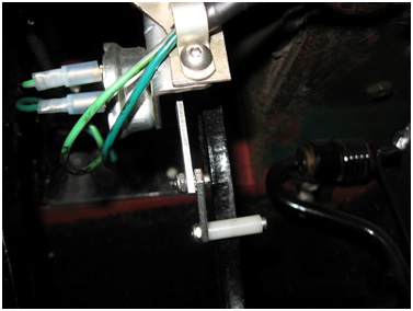

I replaced the original hydraulic brake pressure switch with an adjustable mechanical switch after the original and a succession of available replacements failed. The argument given by the mechanical switch seller (Watson's Streetworks, https://www.watsons-streetworks.com) is that in pressure switches the contacts do not "wipe" each other as they close, they just touch. This allows the contact surfaces to oxidize and they don't work as well as when new. I know the replacement pressure switches from Moss didn't last very long.
I've had the mechanical switch installed since November 2006 and almost 40K miles and have had no problems at all with it. It's kind of expensive, at around $28 (including shipping) when I bought mine, but it is very well made. Ooof! I see that the switch is now 40 bucks. I don't know if it includes that relay-looking thing shown in the photo at their website. I just got the switch.
With the mechanical switch, you leave the pressure switch in place in the hydraulic manifold to seal the fluid, then disconnect the wires and run them to the mechanical switch. Of course, you have to make up extensions for the wiring.

I installed the same switch from Watsons-streetworks. As great as that switch is, it most likely will have a wear problem down the road.
Someone pointed out that my breaklights were not working. Narrowed the issue to the watson's switch. Opened the switch up to find that the brass plate the switch lever rides across had been worn down and a groove was made. The lever that made the groove therefore would not make the entire travel needed. I ground the brass plates smooth to rid it of the groove and it fixed the problem. Will I have to open it up again sometime later to do the same? I feel there must be a better mousetrap switch made by someone else, but who?

A common test for the brake switch is to remove the two wires carefully and connect them electrically (paper clip, wire, needle nose pliers, etc). If the brake lights come on, then you know all the electrical stuff is working, meaning that the switch is the culprit.
The wires that attach to the switch have female spade fittings, and the switch has male spades. In removing my wires, the male spade part actually broke off from the switch instead of the two parts of the connector coming apart. So that was a hassle I didn't need, but perhaps you can avoid the same fate by removing your connectors more carefully.
Because of the low quality hydraulic switches sold these days, some have installed an additional relay which carries all the current. Dave Dubois discusses this on his website and even sells the relay circuits for a fair cost.
