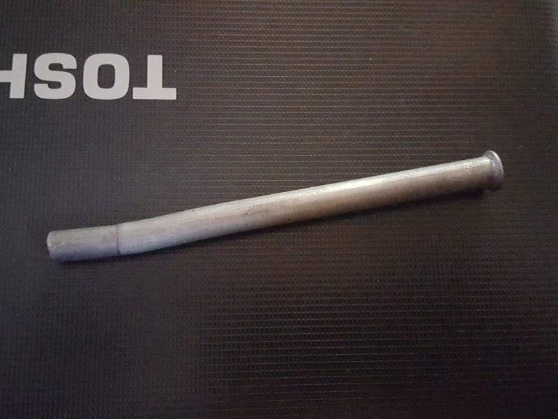

I tried this morning, adjusted a small vice grips with curved jaws to just go around the tube and catch the lip on top. Tapped gently upwards......nothing. Tried a little heat, same result, however, my efforts were hampered somewhat by the wife being asleep and the bedroom being above the attached garage. Currently have some PB Blaster soaking in, will try again later, but the method holds some promise, as the tube held up well.
glemon
More heat more tapping, success, let me know where to send it. Greg 20160327_091029.jpg
