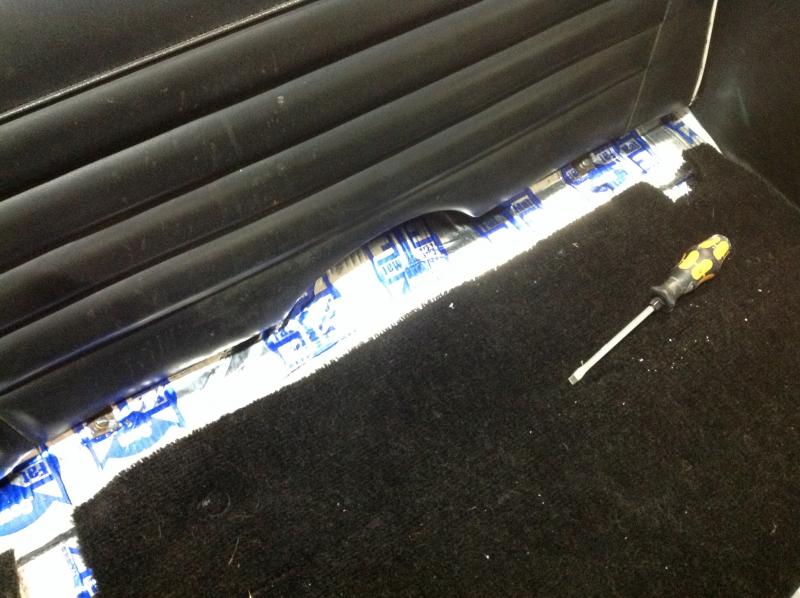

Afternoon all. Another question about the mill board. How does the bottom mount? More correctly to what does it mount? There are 3 screw holes across the bottom but I don't see any corresponding brackets or mounting points on the body????????????
Your thoughts and tips greatly appreciated.
Tinkerman
John_Progess
Tinkerman,
If you are talking about the back board of the inside of the boot(trunk), my 60 TR3 has three angle brackets welded to the floor. These brackets are made from about 22 gauge material, each leg of the angle is about 1" wide and they are about 6" long. The backboard attaches to these brackets with sheet metal screws with finishing washers. Hope this helps and have a good day!

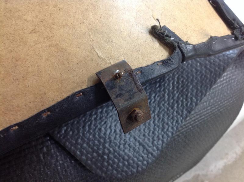

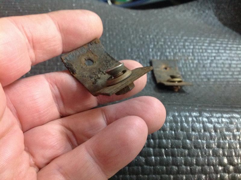

M_Pied_Lourd
I'm not sure if you are talking the interior or trunk panel....here is how my interior panel was fastened at the bottom.

Tinkerman
Tinkerman
Hit the nail (heh) Tush. Where did you get those little rascals. TRF is sending me some trim items maybe they are sending me some of those.

carpecursusII
Just make a few. They are maybe 1/2' wide, 1 1/4" long with two holes. If you want exact measurements mine are out in the shop, I'll do it tomorrow.
Tinkerman
Tinkerman
Thanks for the pictures, I see what I need and can fabricate some replacements. Based on the holes on the back board they only used 3 or perhaps four. Since all of that sheet metal is new I will have to come up with some new ones. Not a problem though.
