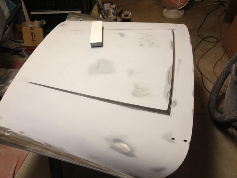

Have fun painting. Epoxy primer can also be brushed on. That works great if you just want to seal your bare metal and come back to the repair later. Some people swear that epoxy primer is needed to seal the bare metal before filler is applied. There are diverse opinions about that - I put my filler on bare metal, per the directions on the can. Epoxy primer has a long pot life (in mild temps, you can mix and shoot it for a couple days). Other primers are more like 30 minutes (poly) to 1 hour (urethane).
Check our Southern Polyurethanes for Epoxy Primer. Barry is owner. He answers his phone all day and is a huge tech help. I used his clear on my car and thought it was a great product for a home paint job. Also very economical when compared to PPG and other big names. Kirker Enduro Prime is also good epoxy primer and you can buy that on line. It is very economical. Rumors have it that Eastwood's epoxy is actually Kirker, repackaged. I really like SPI's urethane primer. Put a couple coats of that on a nearly finished panel. Wait an hour. Apply guide coat, and sand to 400. It is great stuff.
Best of luck. That is the fun part!
Pat

Well Pat I hope to get my hood to that point soon--- looks good. And yes for sure the block sanding and touching things up is a lot more fun than banging rust and old paint off. Have not done much yet, but what I have done is actually fun and rewarding. You have been a big help, much appreciated.
Steve
