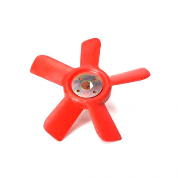

The 5 bladed red plastic fan sold by DW is a repurposed BMW 2002tii fan. If you are able to do a little custom fitting yourself, perhaps ordering the BMW part is a little cheaper.
Looks like DW includes a center adapter.
shortsguy1
Yes, I agree DW includes a large round piece of metal that fits the center hub, which does not come with the fan if you purchase elsewhere. Also, if you use the 3D viewer on the DW website, you can see that they had to drill new holes through the center hub for our engines.
I have no idea if shipping from the UK to Canada is expensive, but I just wanted the original poster to understand he may have other options if he has some of his own manufacturing abilities. I certainly don't want to undercut DW, as those sorts of businesses are invaluable to us. If the original poster had been in the UK, I would not have mentioned it.

The center adapter that steveg noted above with the DW 5 bladed plastic fan appears to be some sort of reinforcement at the bolt holes. It provides no additional depth to move the fan towards the radiator, so that is a little different than what Keoke is describing.

The cost of the DW fan with hub adapter is $60.80 USD plus shipping; the BMW fan on Amazon is $54.17 with free shipping (US only maybe) - so unless one has access to free or nearly-free machine work and the desire to do the engineering, it makes economic sense to buy the DW product.

Just to help anyone else out who is maintaining a Healey on a tight budget (I know, I know, a nearly impossible exercise), the BMW 2002tii 5 bladed red plastic fan is available from several vendors at a lower price than Amazon. In fact, the MSRP at the BMW dealer is $41 USD, so you can definitely find it for less than $40 online. If anyone cares, the part number is 11521255505. Steveg is absolutely right that DW's price is very fair and the savings of going directly to BMW are modest at best.
