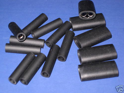

Adding to Doug's excellent post, while you are peering into the wheel wells looking at the wiring (best to remove the tires for room) look for the ground wires that are held to the body by headlight housing screws. Loosen, clean and abrade the lugs and mating metal areas and hardware, cover with some dielectric grease and reassemble.
Lucas Prince of Darkness hahaha whatever. Lucas electrical systems are quite conventional and ordinary. The greatest weak point however is their use of bullet lugs and spring metal sleeves as junction points. The metal alloy sleeves fatigue and crack rendering them in-op. You will find some of these in the headlight harness behind the grill. Do go to the trouble of checking them, but you might as well order some to have them on hand because just the act of removing a bullet lug can break the contact sleeve. Once you know the front wiring is good and there is still a problem I would head to the dash area BUT do inspect the harness all over for signs of some previous owner modifying the harness. People do silly things with wiring.

I have a bugeye, but I think the wiring is similar. They use a lot of those 4 terminal bullet terminals to bring grounds together for the headlights, blinkers, etc. This makes it tricky to diagnose issues because if 2 lights are supposed to be on at the same time, and one of them has a bad ground it can ground through another bulb making things look OK, but dim.
The easiest way to start trouble shooting is to REMOVE ALL THE BULBS and verify that each socket has a good ground. If you don't remove all the bulbs, you will still get continuity for any that are wired in parallel.

The female sockets for the male bullet connector are indeed problematic and as Tom said, you will want to buy some bullets and sockets to keep for replacements and spares. Though you will be able to buy these from most of the usual, car specific parts suppliers, it is a good idea to visit the britishwiring.com web site. The folks at britishwiring.com will have most if not all the basic electrical parts you need including the correct color coded wire for repairs. Their prices are typically better also.
