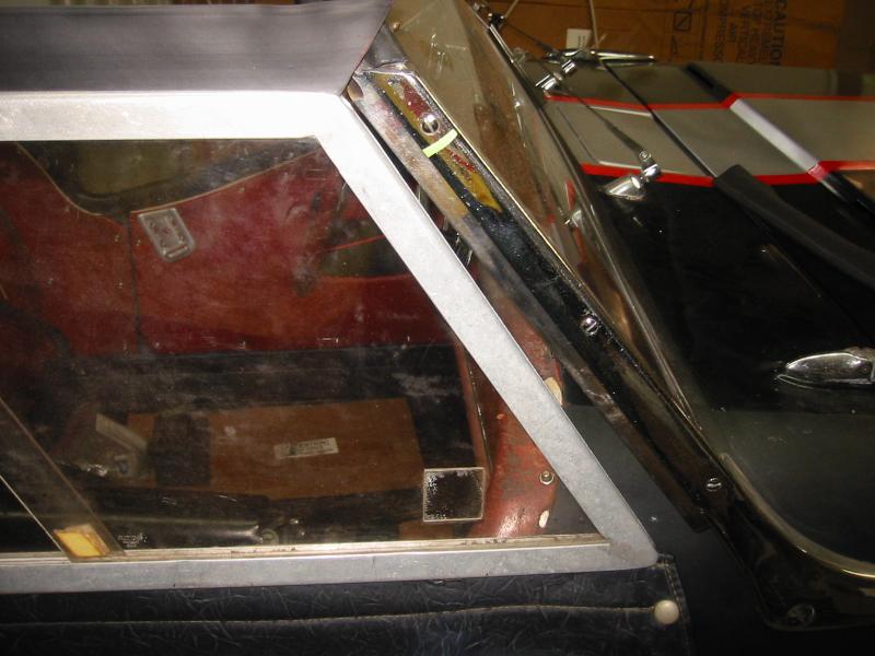

I am replacing the rubber seals in my aftermarket side curtains on my TR3A. The side curtains were old and in the boot of the car when I got it. I got the new rubber seals from Clarke Spares and he says to trim the rubber to make the side curtain fit. The problem I have is that when I snap the bottom vinyl in place using the tonneau Lift-the-Dot connectors on the doors and other snaps, the side curtain front edge ends up not sloped the same as the windscreen. I really don't want to alter the bottom vinyl piece, but is there any other thing I can do to get the front of the side screens to match the slope of the windscreen? I guess the other option is along the front of the side curtain is to trim the rubber way back at the top and hardly any at all on the bottom to make that match the slope of the windscreen, but that won't look very good. Any ideas? see atached picture.

The early curtains have flexible bottoms, so they must be snapped to keep them from flapping. The later curtains have a rigid lower frame, with only a single snap that doesn't use the lift a dot studs.
If yours are aftermarket, they could be either style. One thing to note, the lift a dots are installed by hand, so no two cars have the exact same spacing pattern. Once a curtain is fit to a car, it is unique to THAT car. So, your curtains may have been fit to a different car and transplanted to yours...

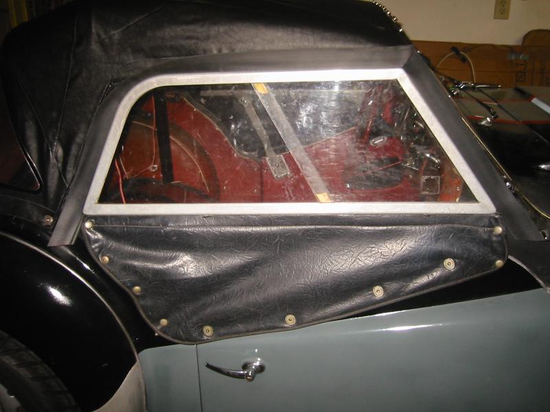

Yes, it is likely that the side curtains I have were not originally made to fit my car. I've had to do a lot of fixing and changing to the door mounts, and bending of the "stand" aluminum pieces. But I'm wanting to make do with them since my TR3 will be just a kinda ratty driver. Does anyone have picture(s) of the Amco aftermarket side curtains installed on their TR3 with the top up so I could see how they are supposed to be when mounted correctly? I'd like to see how the front matches the slope of the windscreen, and also how they should fit along the top where the side curtain meets the flap on the soft top. As I have them right now, the metal along the top is even with the bottom of the soft top flap. (see the attached picture). Is this correct?
Another question is how are the side curtains supposed to fit under the flap on the soft top? When you get into the car, do you have to reach out through the window and tuck the top of the side curtain under the soft top flap? As can barely be seen in the attached picture, the flap on my soft top is even with the bottom of the inside of the soft top, so from what I can see the only way to get the side curtain under the soft top flap is to specifically tuck it under by hand.

TRTEL
Bob, I remember having to install these in the mostly Triumph garage I worked for eons ago. And distinctly remember the angles were always off slightly. There were a number available from Amco, Haan, even JC Whitney. All constructed more or less the same. All aluminum and the sliding window frames were always made about an inch smaller in all directions than the original steel ones to allow the installer to center them based on the fitment of the original. Then after centering and measuring 3 times came the worst part, having to cut the **** seals to fit right upon closing the door. Hopefully your window angle is not off from previous owners and passengers yanking on the windshield. Some adjustment can be effected by loosening the dzus locking plates on the doors. Removing the two fixed screws and loosening the slotted ones and moving one way or the other. Obviously this would leave an impression showing in the vinyl, but if its just a driver. The process leaves about half or less of the seals width as provided. All I can suggest on the flaps is have some new vinyl sewn in and put in new fasteners.

Strictly the PO's idea of trying to eliminate drafts. Maybe a contortionist. You're probably better off not fooling with windshield and just go for the best spacing by eye.
