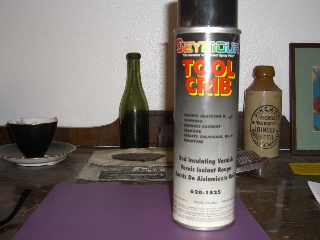

Gotta question for any of the EE types out there. I have removed all of the field coils from the yokes (housings). I have always wondered about painting these assemblies. The field coils are wrapped around a core that is screwed inside the yoke. Can the cores be painted, or do the magnetic properties depend on direct metal to metal contact of the yoke and core?
sp53
You mean something this. It is varnish rather than paint.

I don't believe the paint itself would be a problem. If there was any issue, it would be the thickness of the paint holding the coils farther away, but I can't see that as being a problem.

Thanks Steve, Randall. The yokes will be closer with paint, but I think the clearance is far greater than the thickness of the paint would be. I guess I'll go with a clear laquer or varnish, as they are thin and should protect the steel from corrosion.
