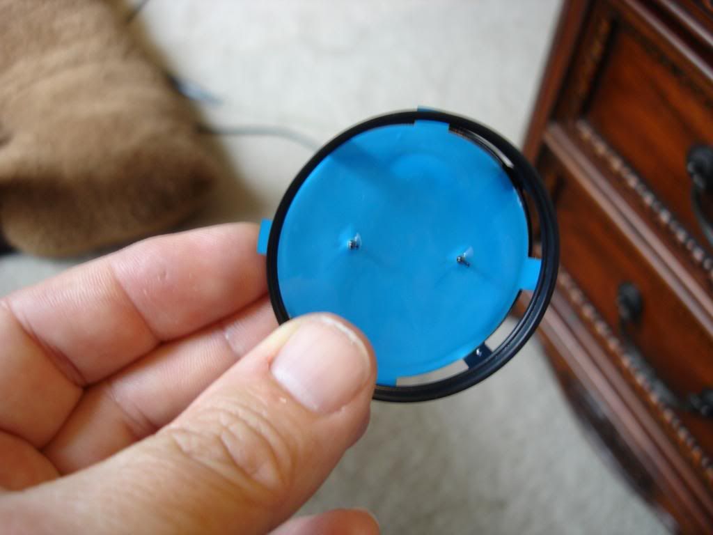

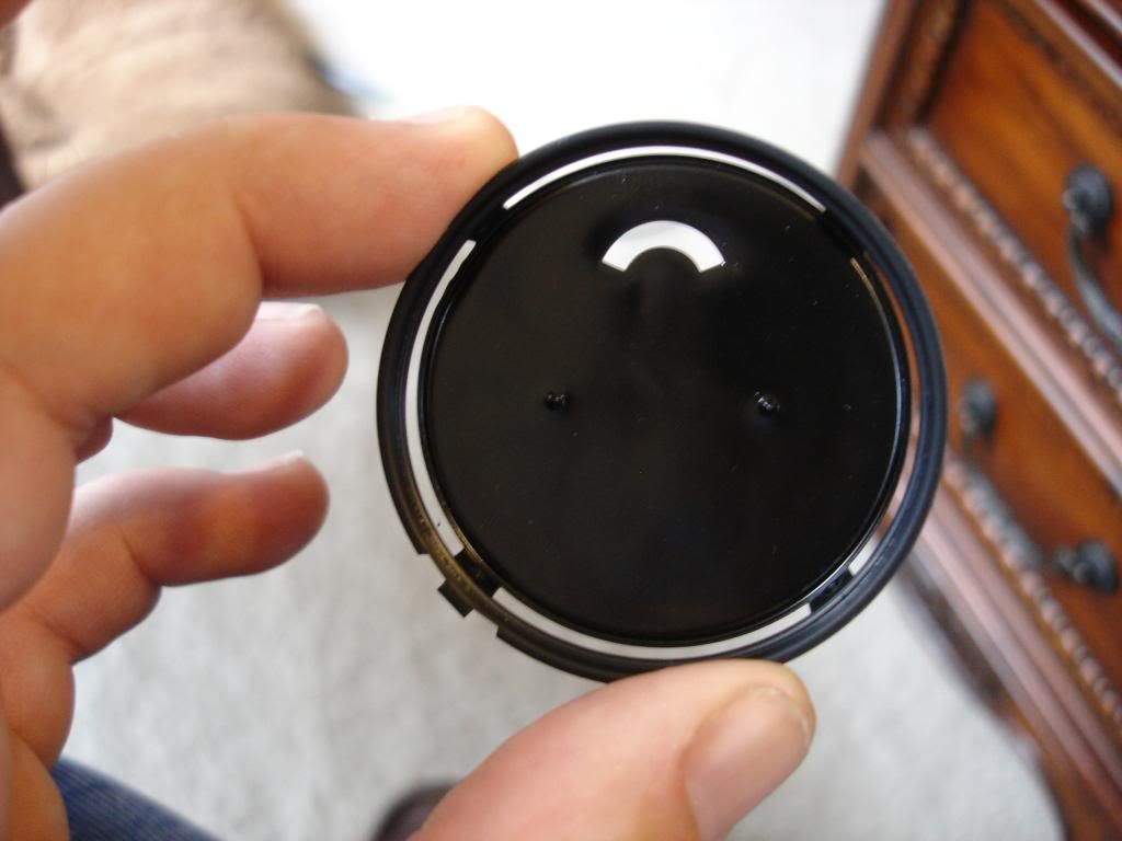

You hit on my current first choice, George. The stencil, made of laser cut vinyl will be a cinch. The trouble is the curvature of the metal face. It is flat in the center, and then has a concave dish around the outside. It is enough of a dish that the vinyl will stretch...but will distort the lettering as it gets stretched, assuming I cut the stencil before stretching it over the face.

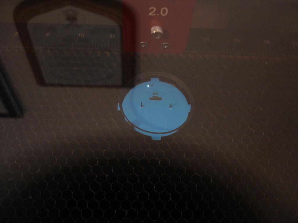

Another option is to fully cover the face with vinyl, then cut the stencil in place. The down side of that is the focal point of the laser is rather sensitive to distance. The 3/8" depth of the dish will make a difference, so may cause a problem. But, it may not.
Luckily I have the gages from Marv's parts car to play with. Right now I am gathering options and techniques...then I'll move to the experimentation. Pictures will follow once I get going!

Elliot, spent a lot of time studying pad printing. I see what you are saying. The pad is loaded from an etched steel plate. Ink is squeegeed into the etch. And the pad picks up the ink. Normally the steel plate is optically etched using a many step process. The steel is needed for low wear when printing thousands of parts.
This has potential! I will only be doing a couple, so I can skip the steel plate and directly etch a plastic plate using the laser. The difficult part will be lining the instrument face up to the pad. I see on utube that it takes the pros a long time, and several bad presses, to get it lined up. I have some more thinking to do...
George, the vinyl I would use is stretchy, adhesive backed, sign vinyl. The laser can be turned down to go through the vinyl, but not completely through the underlying paint. It will etch the black paint a bit, but the following paint coat should fill it in.

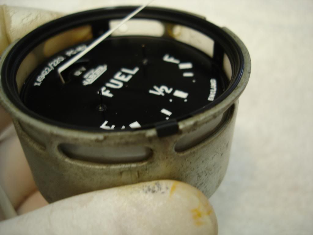

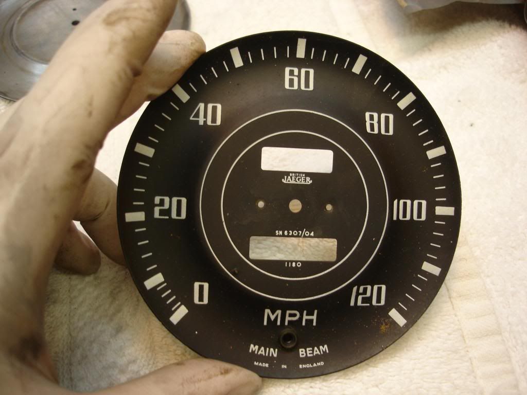

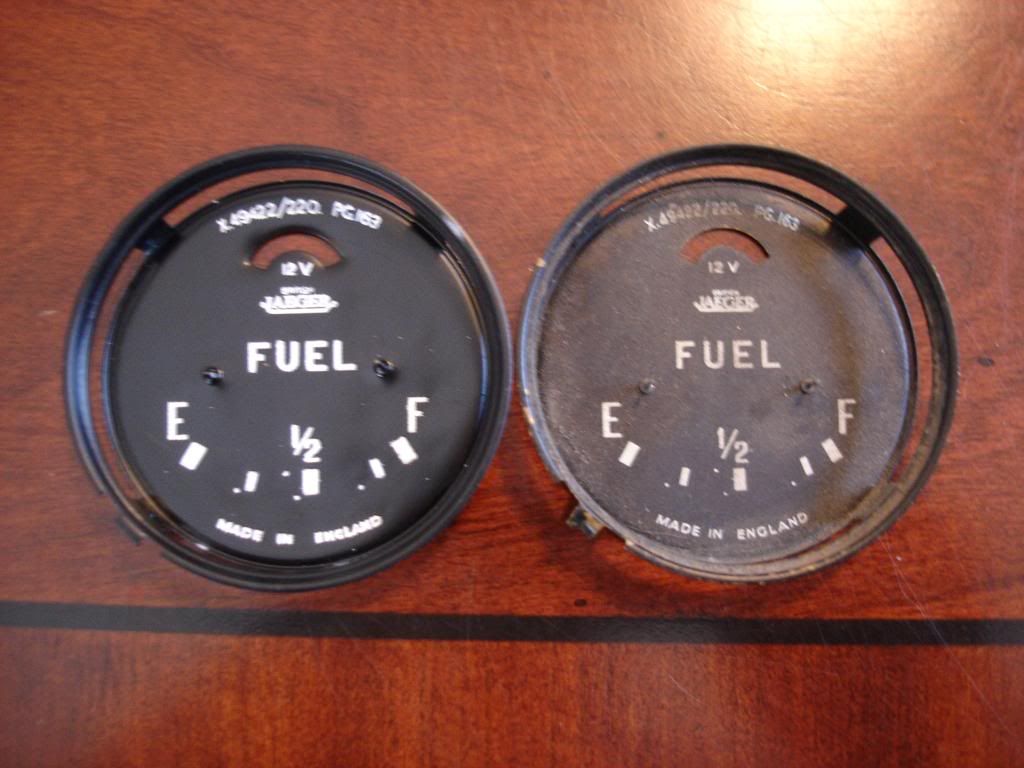

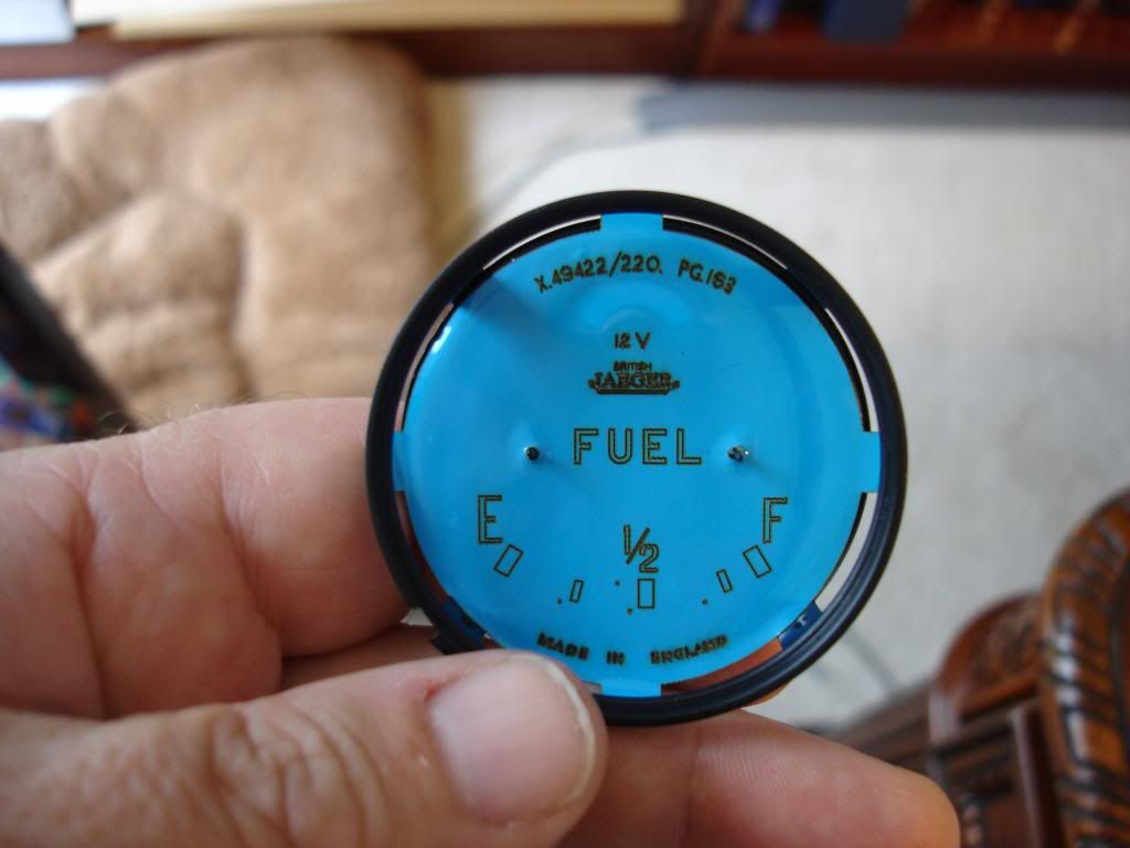

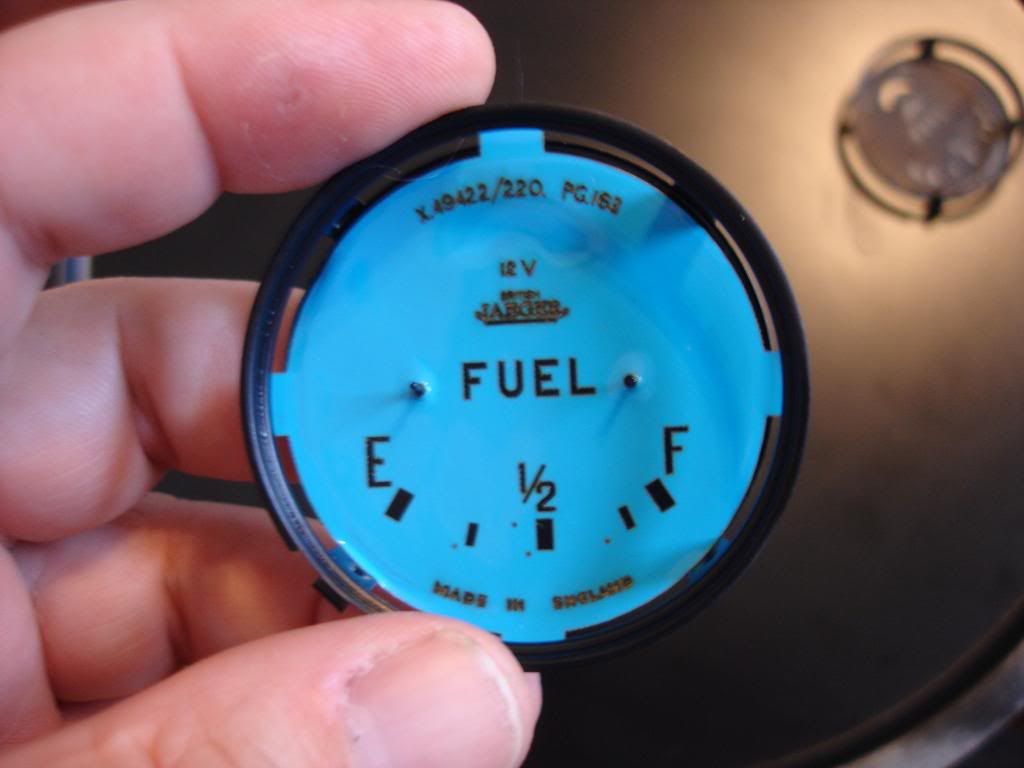

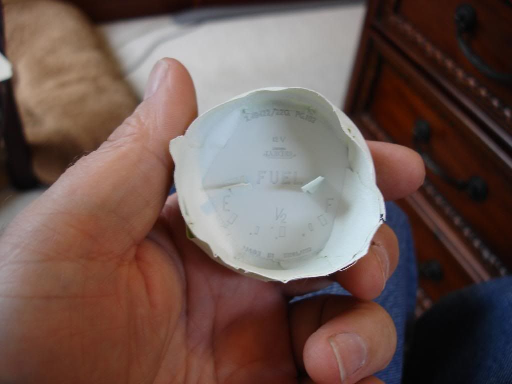

Alright, here's where I am so far. These are the faces I am working with:
The one on the left is the TR2 face, and the right is the donor. If you look closely, you can see the black background has turned chalky on both faces. The red on the TR2 is no longer red. The plan is to strip the right gage and make it a new version of the left gage. After studying the technics available for more than a week...I will opt for the laser-cut mask. I will cover the gage face with a vinyl covering, and then laser cut the parts that will be white. I decided that the silkscreen method is 1000 years old, and it would be a major step backward to get up to speed on it.

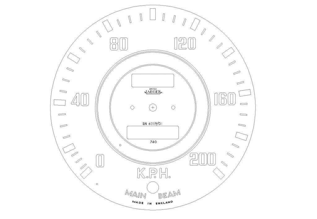

Here is a screen pic of the Tach after 2 days mapping it on autocad. It looks simple, but it is actually a whole lotta work! Each mark was mapped with a protractor and then built in the computer. The original face looks very precise...but I learned it is not. Silkscreen is a "that's about right" kind of printing. The laser puts the marks exactly where you want them. I have had to "dumb down" the CAD drawing so as not to look better than the original printing.
Now I'm into the paint. Acryilic, enamal, laquer. The studying goes on...

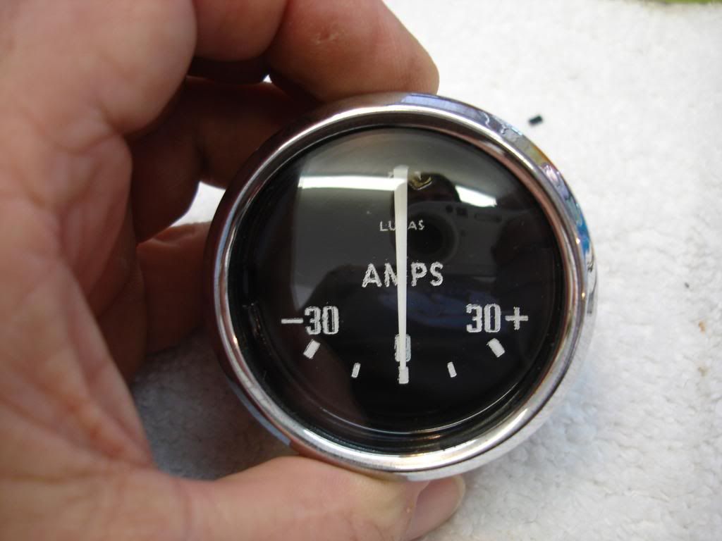

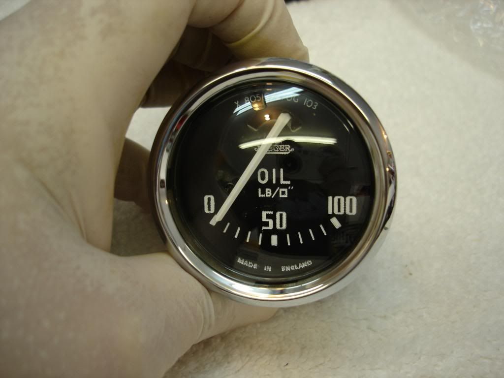

John, did you find a font that worked or did you create the numbers in ACad? That Jaeger text looks GREAT!
The last time I worked on matching the fonts I gave up using commercial typefaces. I made careful photographs of each number which I then put in my CAD package as a background. I constructed lines on top of the photograph to outline each number then solid filled (hatched) the interior. Each number was then made into a block so I could manipulate them.
Regardless, I feel your pain. Laying out a gauge face is an awful lot of work. The nice thing is that with today's software and a quality inkjet or laser printer you can get nearly perfect 1:1 printouts to examine how your artwork will look on the actual gauge face.
