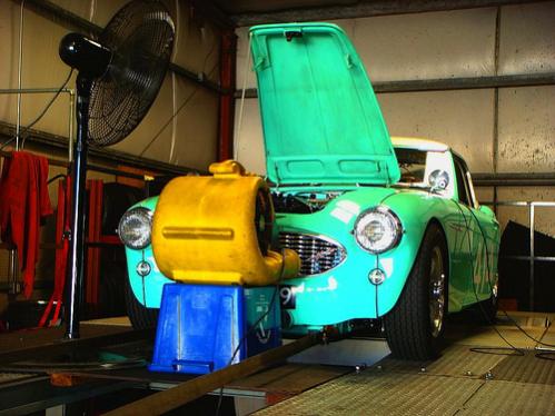

I've used Joe Gibbs BR Break-In oil in my last couple rebuilds. I've been happy with the results.
https://www.joegibbsracingoil.com/products/enginebuilder/index.html
