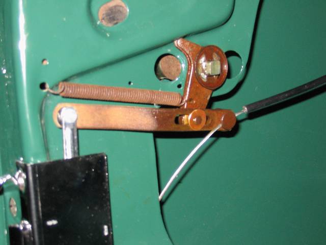

Luke - Here is a photo from the BRG TR3A we finished in 2006. It's a late TR3A (TS 81551 L) compared to your "early" door. And my photo shows the door mounted on the LH side. My point is that while we can't see you doorhandle on the far side of your photo, I can tell you that the handle is aiming upwards at about 45 degrees or it's drooping about 45 degrees.
To get the handle to sit correctly (horizontally), the square end on the handle we see needs to be horizontal too. To get it this way your "dog-leg" link needs to be more vertical as in my photo. You might have to releive some interference where it stops up top - or you might tack-weld a larger curve on the top of the "dog-leg".

I think the important part I am missing is labelled #2 above. here is what I have right now.....you can see the remains of some solder in the background.
I am wondering if there used to be solder in there holding the handle? The piece was seized, and I took the torch to it. I wonder if I accidentally melted the solder?

That round piece of pot metal with a point on it that fit on the square shaft of the door handle is something you can not get from one of the usual part supply houses. The point keeps the latch mechanism from slipping as the door handle turns to unlatch the door bolt. Probably your best source is John's offer. When I needed one, I asked fellow members of the forum and they helped me out.

Hi Yvan - that sounds like it would solve the broken locking ring aspect, but the pot metal piece will be more difficult. And it is critical b/c thast is what makes the door handle activate the linkage.
