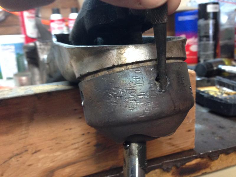

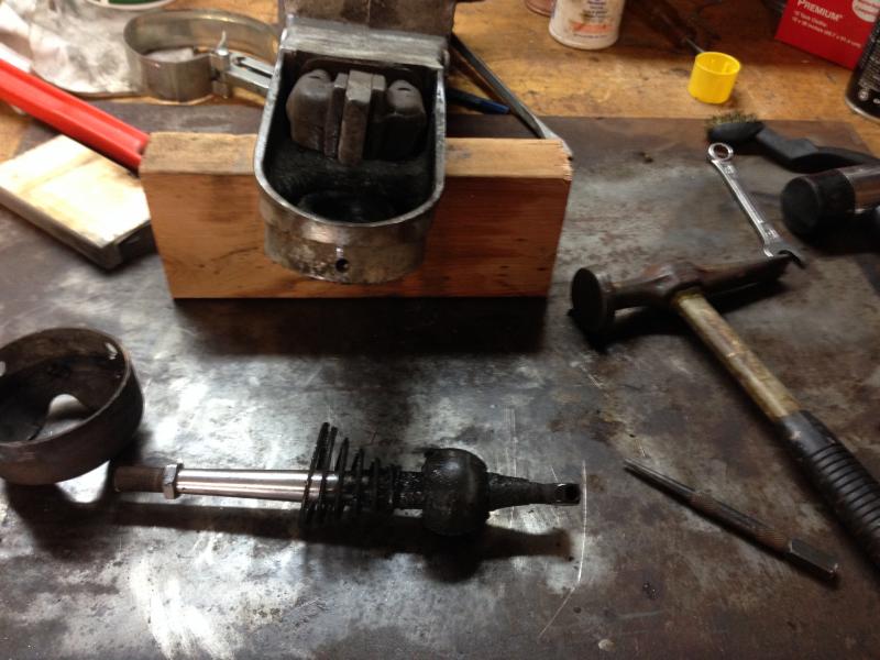

Here's the wrap-up on the shift lever cap: I spent another few hours this morning fighting with it, and decided it was going to have to die so that the rest of the car (and my sanity) could live. Thankfully, a forum member offered me a spare cap, so I knew I had a replacement lined up. If was definitely stuck on there good -- even after cutting all the way through it, I still basically had to "peel" it off the transmission top.
