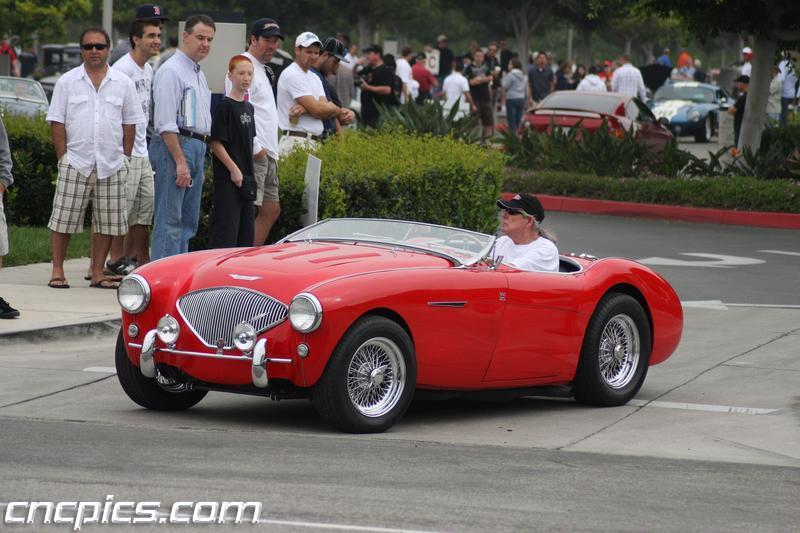

.....I have Dayton's on the Healey Chevy, and have been very pleased.
