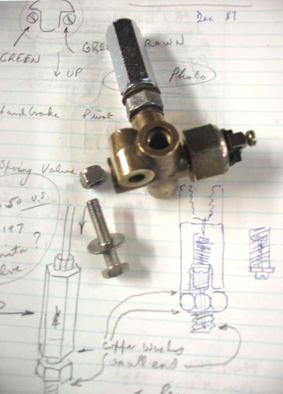

All,
My restrictor valve (TR4) went south on me this weekend and all but locked the front brakes. I took the restrictor off and gutted it as I pulled it off. Master Mechanic here :smile: would like to find out how the two pieces fit back together. Here is my educated guess. Any feedback or idea are very welcome.
Thanks
Tim
Don Elliott
The photo of mine also shows a sketch I made in 1987 when I restored my 1958 TR3A.
The lower piece in the colour photo in the preceeding is wrong way up. The TR2, TR3, TR4 Haynes Manual shows it like my sketch.
