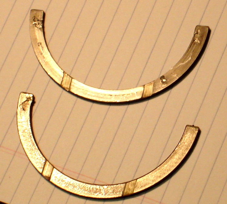

Thanks to a number of discussions on this forum, I thought I would check the Spit's crankshaft end-play. Not too bad, actually, at .013", but out of spec (.004"-.008"), so I pulled the oil pan and fished them out.
They were not all that badly worn, and still had some alloy on the bearing faces, but as you can see in the pic, they had started to delaminate. The rear washer is pictured on top, and it was the worst of the two.
Hopefully those little lost bits of washer got sucked up by the oil filter.

Those are pretty nice, compared to some that I've seen. I've seen them half that size in the bottom of a pile of shavings in the pan. Needless to say, the crank needed work.

The ones I just pulled from my temp 6 engine got ya beat. My crank does need turned, but I'm just buying time with parts I have on the shelf. I'll be spending the money on the new motor.

It looks like you got to them in time.
It's an easy and cheap fix.
I have seen plenty of these cars where the thrust washers have fallen out due to wear and they are in the bottom of the oil pan.
I wish that all Triumph owners with engines from this "family" (Spitfire, Herald, GT-6, TR-6, etc.) would check their thrust washers before they do irreversible damage.

As others have noted also, these weren't too bad. The reason I checked them in the first place is because of what I had heard here about tw's falling out and totalling the crank. Given the relatively small amount of play (.013") I was pretty sure they were both still in place. What surprised me is how they were deteriorating. I had just expected them to be worn down, i.e. a little thinner, not breaking apart.
As you say, this is cheap preventive maintenance.
