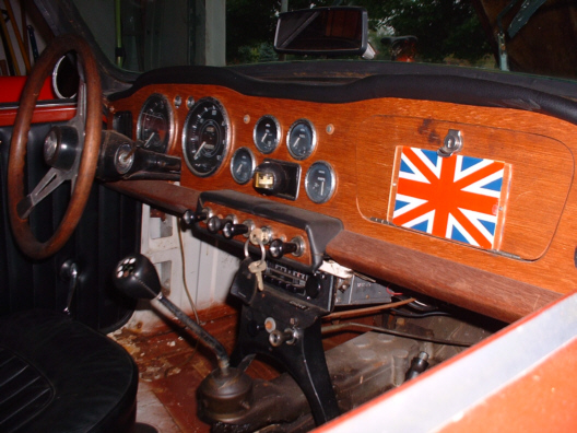

    Hi all:
    Was the wood dash an option on all years of TR4s? My new '62 has what looks like a homemade wood dash and I was wondering how I could determine if it originally came with one. I can see some white paint around the glovebox door, but then the car was white originally so that might not mean anything.
    Thanks for your help.

    If your glove box door is metal, then I'd say for sure you had a metal dash - the wood option would only have a wood door. From the factory parts manual, they list the veneer dash as a special order for the TR4, but don't say if it was offered after a specific commission number. It seems like they started showing up in the 64/65 model years though.
    The arm on the glove box door is a straight looking arrangement for the wood dash, on the metal one I believe it is curved.
    Another potential clue would be the ash tray - the bracket for the wood dash option is shorter than on the metal dash to accomodate the thickness of the wood dash.

    First of all, it seems as if the department at the Triumph factory where the dashes were made only ever had one can of paint [img]/ubbthreads/images/graemlins/rolleyes.gif[/img]. Every TR4 came with a white-painted dash, no matter what color the exterior of the car was originally painted. In fact, the color used was Spa White (an off-white) and it even continued to be used after the cars' exterior white color choice was changed to New White in later TR4 production.
    So, IMHO a TR4's metal dash will have always been painted Spa White, even if a wood dash was later installed over it.
    I'm pretty certain Spa White painted dashes actually continued to be used through most if not all of TR4A production, too, perhaps even on into the TR250/5 era when wood dashes were standard.
    Note: Bill Piggott states the white color change occured about CT21xxx. New White is a slightly "purer" white. I believe that is true for the exterior. However, he states the dash color was changed at the same time, which I disagree with from seeing with my own eyes Spa White that was still used on dashes at least through most TR4 production, and possibly even on some TR4A dashes, hidden under the wood facia.
    Also note: Moss Motors lists Spa White as the only exterior white color choice of all TR4 and 4A. I know for certain this is incorrect. Spa White was a carry over from TR3A production and was replaced by New White during TR4 production, at CT21xxx/mid-1963, as noted above.
    During TR4 production - at least early on when the TR4 spare parts catalog was first compiled - only a left-hand steering wood dash kit was offered as a special order option. (Granted, not a lot of RHD cars were being built, the vast majority were exported to LHD countries, especially the USA.) Most likely a lot of TR4 wood dashes were installed at dealerships, since it was an optional/special order item available in kit form. I would imagine it might be ordered fitted at the factory, too, but that would usually only happen if the wholesaler or dealership chose to do so, or if a customer placed an order very far in advance. However, many TR4 were built and stockpiled - there were many months supply built up at times - its most likely the dashes were retrofitted even if done at the factory.
    We can pretty much assume that practially all the cars for the first few years' production shipped with a painted dash. So, as a '62 it's a pretty sure bet that your TR4 left the factory with a painted dash and had the wood dash panel added later. The question then is whether that was done by the dealer or by one of the previous owners.
    Note: Piggott states that wood dash kits first became available for TR4 in mid- to late-1964. I question this statement. The "wood veneer" dash kit listed as an option in earlier TR4 spare parts catalogs. I would say it's far less common, but am pretty certain it was available earlier. Perhaps it was just not yet recognized as such a highly popular item with the buying public and was not yet very well promoted. It's not even illustrated in the TR4 parts catalog, only listed as line items.
    Even if Piggott is correct, an earlier car could still easily have been fitted with a wood dash kit by a dealer in 1964 or later.
    Also, FYI, the TR4 parts catalog lists an optional/special order wooden steering wheel to match. I don't know who the manufacturer was, though, and it's also not illustrated.
    The TR4A catalog, shows three wood dash arrangements. These were left-hand and right-hand steering versions, plus a third LHD version specifically for France. (I'd guess there was some additional switch or lighting - or possibly something omitted - on models destined for France, requiring a slightly different dash.)
    &lt;I must amend my earlier statement that TR4A weren't always fitted with wood dashes, after looking it up in an original TR4A parts catalog I happen to have. Yes, Raymond, you are correct in that TR4A came with wood dashes standard. This is confirmed because the TR4A spares catalog doesn't even list a metal dash door, just a wooden one. The catalog also fully illustrates all the parts for the wood dash, and shows it's installation over a metal dash that clearly comes with holes predrilled for the wood mounting screws.This is confirmed by Bill Piggott, as well. Could have sworn I'd seen some TR4A with original, painted dashes over the years, but I guess not!&gt;
    A clue that might help is the TR4's switch plinth. If the original were re-used when the wood dash was installed, the base of the plinth would have to be trimmed to accommodate the extra thickness of the wood. Except for very early cars, I think it unlikely a dealer or the factory would have trimmed the plinth, but instead would have just changed it out for a different version that was made specifiically for use with the wood dash. So, if you find the plinth has been trimmed to fit on the back side that might be a strong clue a previous owner installed the dash themselves.
    Early TR4 used a formed fiberboard plinth, covered with some sort of vinyl/textured material (a bit cheesy and prone to disintegrate over the years). At some point, TR4 started using an all-plastic plinth, with the surface texture molded right into it. I don't know exactly when this change occured, but I still have the original fiberboard plinth (reinforced with fiberglass resin years ago) from my car which was built in late '62 - CT17602L (and actually first registered in 1964, to give you some idea how stockpiled these cars were!)
    So, the materials of the plinth might also be a clue whether or not the original or been replaced, but after than look to see if it was trimmed down to accommodate the extra thickness of the wood. (Note: Reproduction TR4 plinths, when available from Triumph vendors, now seem to *all* be just the molded plastic type and sized to accommodate a wood dash. That means those of us with a metal dash are simply out of luck unless we can find a used, original one. Took me years to find a good replacement! TR4A plinths are different, too - "upside down" from TR4.)
    If your car is very early, somewhere in the 4-digit chassis numbers (possibly a '61 build) the original four-gauge panel in the center of the dash would have been bright chrome-like finished aluminum with a cross-hatch stamped pattern that matches the trim plate behind the switches on the plinth. The gauge panel was changed early on to a black vinyl covered steel panel, probably due to reflections from the bright metal making the gauges difficult to read. The switch trim panel was not changed until the plinth was revised for TR4A.
    The reason I mention this is that - with a wood dash now fitted that panel was likely removed and tossed - if you are considering converting back to a painted metal dash and are concerned about originality you'll likely be looking for a replacement panel and there are two different ones, depending upon the exact commission number of your car. I think Bill Piggott lists the exact gauge panel change point in his "Original TR" book (let me know if you want I can look it up for you).
    The metal glovebox door was usually thrown away, too, when a wood dash was installed. The doors are all the same, though, just a little tricky to find. Yes, as noted, the hinges were different for the metal door, incorporating a curved restraint that only allowed the door to open to a flat, level position. Wood doors have hinges attaching to the wood facia, and a separate restraint.
    The material of the wood dash itself might be another clue. It's not uncommon for homemade dashes to be made with solid wood. However, *all* Triumph wood dashes are plywood (possibly marine-grade) with painted or dark-stained edges and a veneer of finer wood on just the front surface. Plywood was used deliberately (on many other cars too, including Rolls Royce, Jaguar, etc.) since it's much stronger and far more resistant to warping.
    And, wood facia were fastened to the metal dash underneath with chrome-headed screws on all the earlier cars. At some point in mid-TR6 production, these were changed to black-finished screws. Only problem is, screws might have been replaced in years past, so this is only a vaguely useful clue.
    According to Moss Motors, TR4/4A (and TR6) dashes were veneered with walnut wood on the front. TR250/5 are mahogany. None originally used teak, which is now common. And none used a real "burl wood", also now sometimes offered. The veneer typically shows the long length of the grain, with little or no knot or burl.
    There has also been some dispute about exactly how glossy the finish should be on the wood dashes in various models. But, it's pretty well accepted that TR4 and TR4A had high gloss varnish, while TR250/5 and TR6 had a low-gloss finish to reduce reflections.
    All in all, it's really up to you whether or not to use a wood dash in a TR4. The Spa White painted dash of TR4 was pretty unique to that model and certainly makes it stand out. But, retro-fitting wood dashes has been so common that - if it's what you prefer, no judge in any car show would ever be able to fault you for it.

    Just a few added notes. My VIN is CT16610 so it is only a little bit earlier than yours Alan ... It also is titled as a 1964, and I have some paperwork from an engine rebuild in 1974 that was done in CA (I assume that's where your car is from). You mentioned that the "homemade" dashes were sometimes made of hardwood, but mine is definately veneered plywood, and the plywood has the multiple layers like my TR6 dash does.
    I will look at the switch plinth and see if it looks cut, but I am also going to take some pictures and see what you guys can see in them. I know I could take the dash apart, which I will eventually do anyway, but I just wanted to know what parts I should start searching for to return it to its original configuration.
    BTW, were there two "whites" in 1962? My car is currently red but the inside of the trunk is still its original off white. Would you think this is "Spa White", or could it be the "Valasquez Cream" listed in the Moss catalog?
    Thanks again for the awesome help ... I'll post some pics later today.

    Well here's a pic of what started this thread ... I can't tell much about it in person, so I don't expect you guys to be able to tell anything about it from a picture.
    I do know it has been "refinished", and obviously some DPO was a woodworker as the under dash pads have been replaced with wood. The switch plinth doesn't look cut (seems to go under the wood), and the ashtray bracket (from underneath) doesnt look modified.
    I'm still not sure what I'll end up with, but I certainly appreciate everyones help and incredible knowledge. Thanks.
