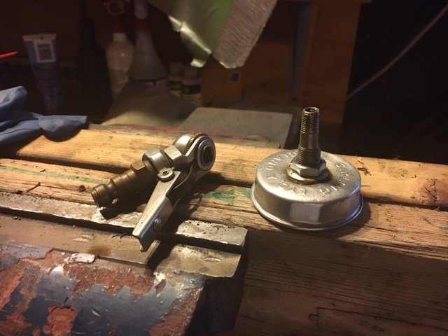

I made a 'tool' for pressure bleeding from a reservoir cap for one-man bleeding. It works well but sometimes if someone's around I'll finish off with the old-fashioned 'pump-hold-bleed-repeat' method. For pressure, I turn the regulator out as far as it will go, below the gauge's range, which I think yields about 10PSI or less. One thing my dad and I learned the hard way is to not torque the bleeder screws down too hard (which is tempting); we couldn't get good pedal on his '46 Chevy 2-ton and eventually discovered that a bleeder seat had cracked. 'Snug and a tug' is about all you need.
Edit: For capture, I use clear vinyl tubing--I don't recall for sure, but it's probably 3/16" or 1/4" ID--into an old, clear mayonnaise jar with a couple holes in the lid so I can see any bubbles (you only need one hole to bleed, but when done I route the bleeder end back into the jar so the fluid doesn't end up where it shouldn't and the tube stays mostly clean). Ratcheting end wrenches--I have bleeders in 7/16" and 3/8" wrench sizes--make loosening and tightening the bleeders a lot easier.
