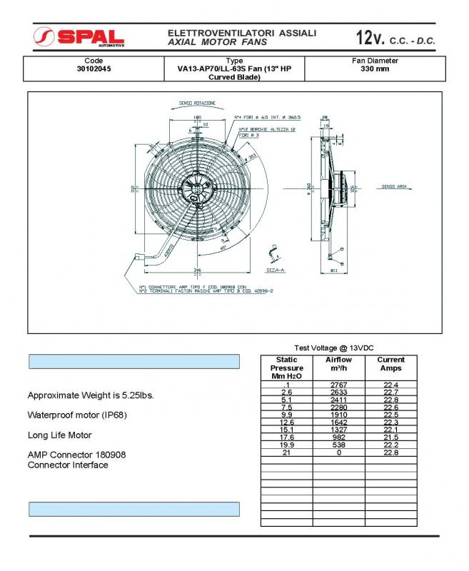

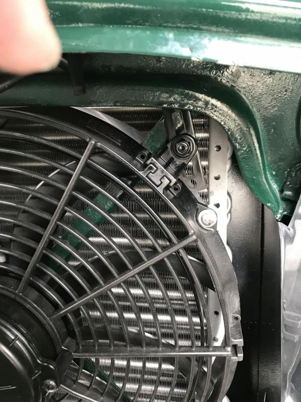

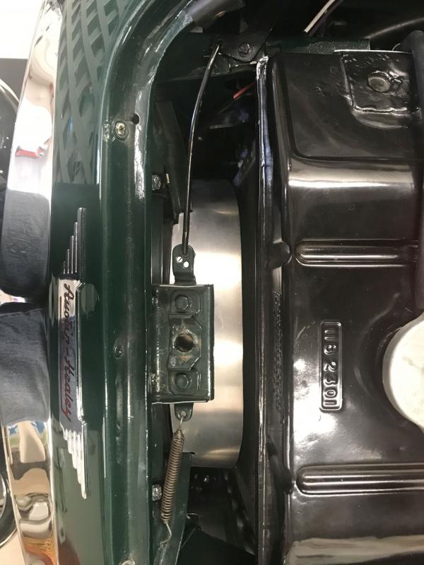

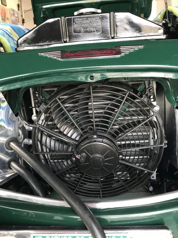

Here's some photos:
13in Pusher-30102045.jpgFan Mount to Xbrace-Red.jpgFan Mount-Red.jpgFan to Condenser Shroud-Red.jpg
Yes, I have it hooked up to a temperature switch in the upper radiator hose and a trinary switch on the drier in parallel.

Here's some photos:
View attachment 65665View attachment 65666View attachment 65667View attachment 65668
Thanks for the photos. I like the idea of a shroud for the electric fan.i don’t have the X brace I like the idea of eliminating the water pump fan and just going with an electric fan. It seems as though a lot of new cars use electric fans now instead of water pump fans. I’ve heard the spa fans spiral blades move more air and are not as noisy.

I have the Spal VA13-AP9. It's slim, with narrow, straight blades.
Keoke,
I have no data and limited experience, but I think whether pusher fans block the radiator is highly dependent on the fan selected.
The Spal fans have narrow blades and freewheel when not in use.

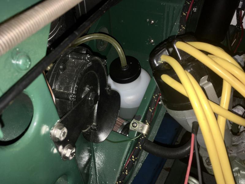

I've got our BJ7's windshield washer bottle and metal basket, sitting perfectly in the same spot as your TR6 bottle is. The idea was to have it an easier location for refilling. I've also found that a standard nalgene wide mouth 1 litre hiking water bottle fits perfectly into the same basket, and have been meaning measure heights etc. with the idea of putting in an overflow, and locating the overflow bottled in the parcel shelf under the dash in place of the currently relocated windshield washer bottle. Later, Doug

i also had a windshield washer bottle as an overflow but once i went to the NAPA radiator cap, i found the washer bottle was not big enough. it would overflow when the engine got hot, after shutdown, and then empty was completely cooled down. Hence i went to the bigger TR6 bottle. with this bottle and the new cap, if i pull the radiator cap off when cold, the coolant is up in the neck of the radiator. Plus when the engine is shut off (hot), it will not overflow.
Just made a little bracket to support it below. the hole is the perfect size to hold it.

Drone Dog: do you recollect what the proper thermostat cap is? I expect a search will turn it up, but feeling lazy this am. and any idea of the capacity of the TR6 bottle? Thanks, Doug
steveg
DD,
That's a good correct-looking solution for cars with horns in that positiion. Moss makes a good repro of the MGB brass tank that can be mounted on the shroud support for earlier cars with horns up front.
