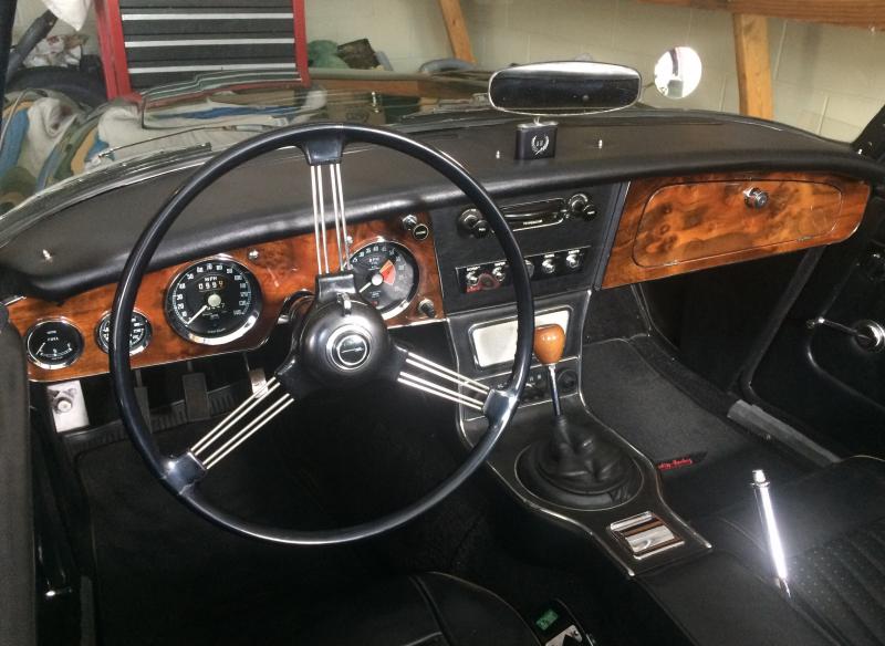

Sorry, but there is nothing like maintaining a certain level of quality that came with the car, IMHO. I took the pain of preserving my natural wood veneer and yes, I even deviated the preservation process by using an epoxy resin instead of the stock varnish (or was it shellac?) applied as stock from the factory.
I was forced to strip down the existing wood finish, repress all raised checked wood areas, then applied the resin finish to my dash about 7 years ago. It still holds up as nice as the day I did it. No regrets there and I still have the original wood veneer to appreciate.
Using plastic to take the place of real wood...Its like correlating the thought of adoring rhinestones and glass over diamonds and emeralds, IMHO.
