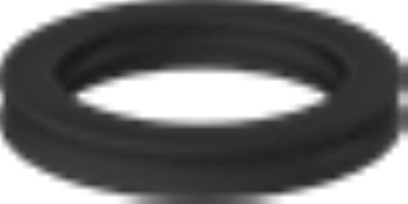

The only thing that I have found that works are quad rings, the size you need is QR-112 ID1/2" OD11/16" they will stop the oil leaking.

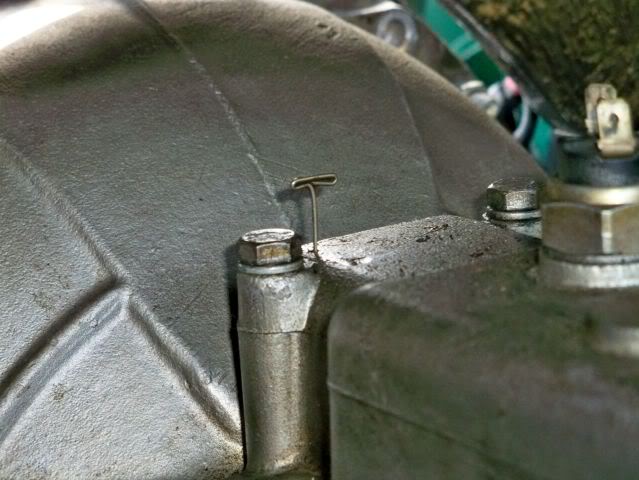

While you're working on it, double check that the air vent on the tail housing is open. If the vent gets clogged the tranny will leak no matter how good your seals are.

Vent hole is in different places on different gearboxes; likely it's possible to assemble a mix that doesn't have one.
