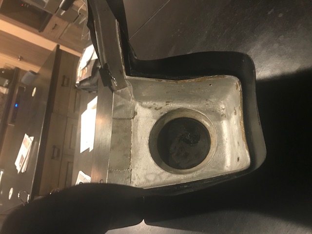

Here's pic of the cover I received from TRF. I'm at a loss how to cut it to bend and form around the legs and shift housing. Any ideas? Angle cuts? The vinyl cover must be bent and folded in two directions, each apparently in conflict with the other--around the legs, but also around the bulbous shift housing seen upside down in the pic. There must be a known trick for this. Just seems like a perfect opportunity to make a mess.
Popeye
Bronze
Smarter folks than me will have better answers, but I assume you need to make some cuts... angle cuts etc. to get that to fold over.
Again, no fun!
PeterK
Look at the lower edge of my 2nd photo (from post above). This is a Moss cover and it already has relief cuts. Notice the holes punched at the end of the cuts to prevent the cut from spreading - very important. The feet also has relief cuts but is more forgiving since the carpet will hide most imperfections. As I said dry fit several times and glue the main sections down and dry before proceeding.
The Moss cover doesn't wrap around the bottom of the center section, your TRF cover is longer and could be trimmed after installing the cover. Carpet hides the edge here too.
hth
Popeye
Bronze
Good point about the stress relieving holes - circle at the end of the cut. Important to keep the split from growing!
