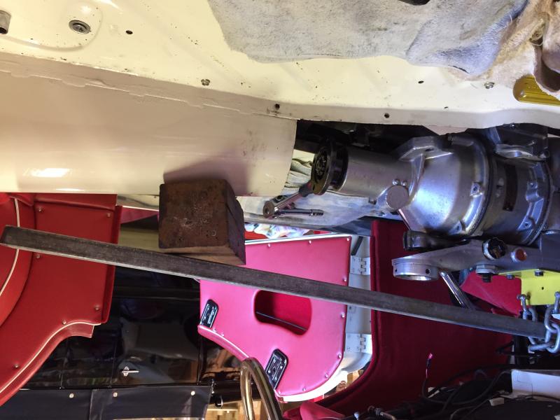

To make the job easy make up my gearbox removal leaver as posted last week, it's simple and takes the hard work out of it. The first photo is on its side and the second one is upside down and i dont know how to fix it can any one help
Graham
TR3driver
Great Pumpkin - R.I.P
If you're a PC user, IrfanView is a free program that performs lots of simple imaging editing tasks. 90 degree rotation is as easy as tapping 'L' or 'R' once, 180 is twice. It can also rotate by mere fractions of a degree (handy when a page didn't align quite right in the scanner). https://www.irfanview.com/

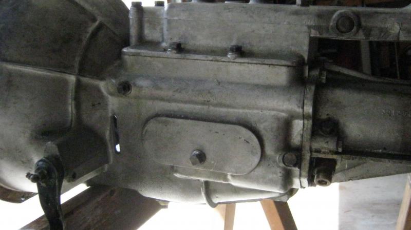

The fill plug is right in the center of your photo, that square headed pipe plug is the fill on the later gearboxes.
Sounds like you might need a copy of Practical Hints, which is effectively the factory owner's manual. Here's a PDF of the 6th edition, suitable for later TR3A and TR3B
https://drive.google.com/open?id=0B2H2NJt34OffNjQ4MTkyNjItZTVmYi00M2U2LWJhYWUtMjEyZDgxMzUyNzUw
