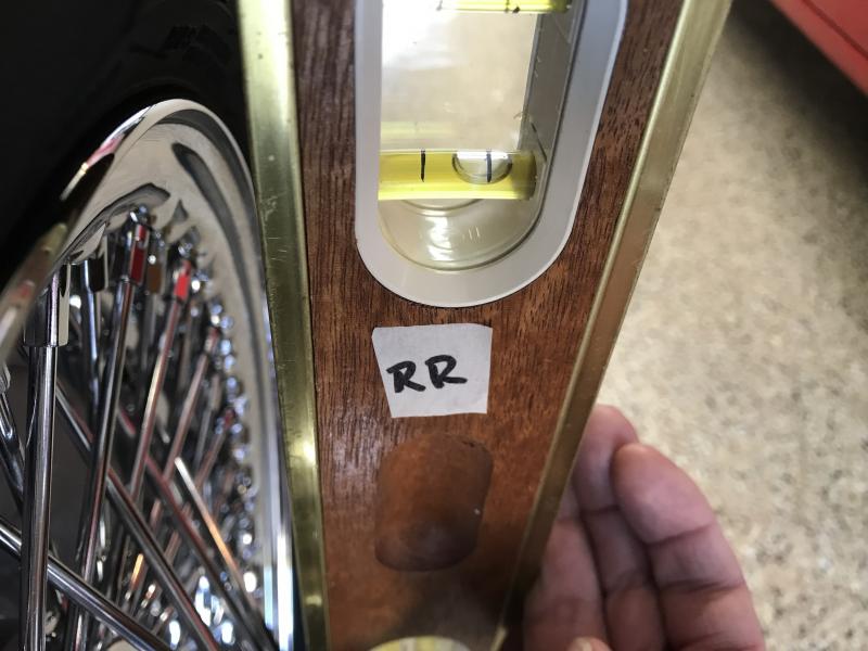

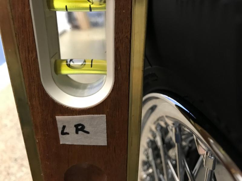

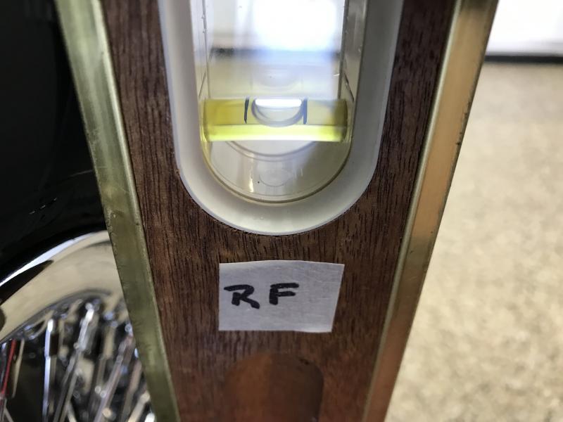

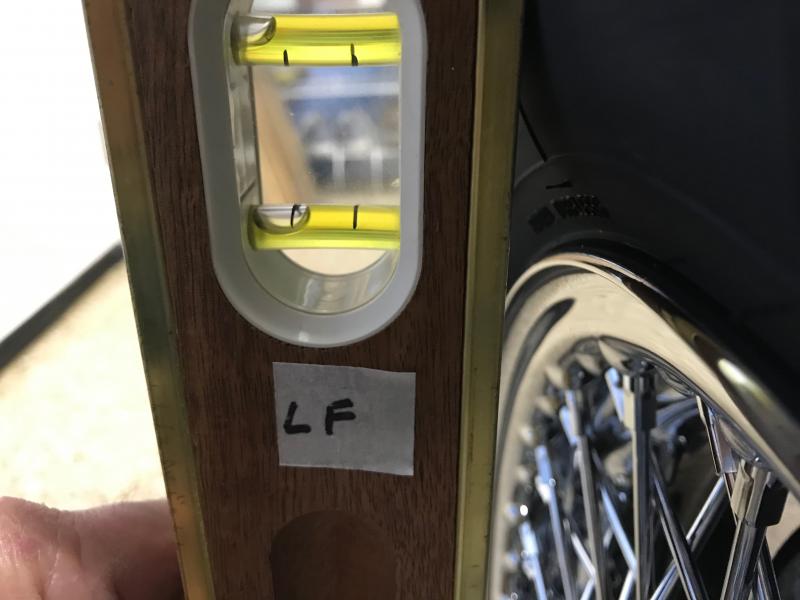

Noticed all 4 wheels have a bit of tilt, camber (if that's the correct word)
I put a level, pressed against tire, vertically on them. Here's where the bubble is on each tire. Only the Passenger Right Front "RF" has the bubble in the middle.
Should all wheels be vertically straight, or is some camber acceptable? How do I correct that?

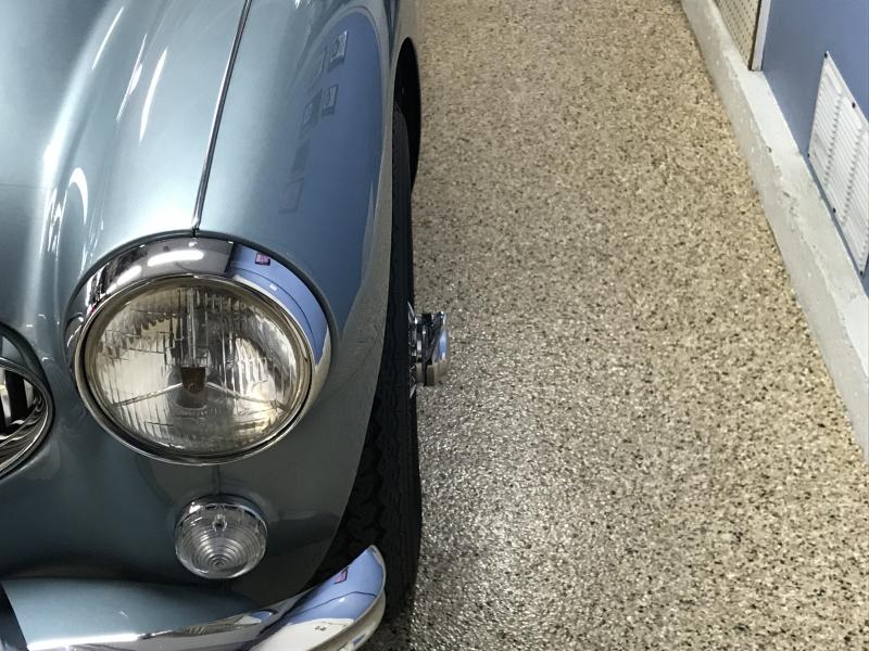

Not easy to see in this photo, but the driver Left Front "LF" has the worst camber.
Car drives straight, steering wheel is centered, no excessive inner or outer wear on any tires. No scuttle shake...thank goodness.
First off, you have to measure the slope of the floor you measured on; it likely has some slope and probably isn't perfectly flat. Assuming it is flat and level, your LF has a bit of negative camber, the RF is 0deg and the rears, well, you can't do much about them anyway. The nominal setting, per the book, is 1deg positive, but alignment guys tell me that 0deg with a little bit of toe-in is best when running radial tires. You can change the camber a teeny bit with offset bushings, but if your car tracks true and doesn't inordinately wear the tires on one side I wouldn't worry about it.
My BJ8 always had 2deg or more pos. camber in front; subsequently the outside of the tires wear quicker than the inside (my driving habits couldn't possibly have anything to do with it ;)). My BN2 came with excessive negative camber, we never figured out why and the frame seemed straight as far as we could tell. We installed the adjustable shock plates from Kilmartin--got two of the defective ones--and have it set at about 1deg+; it drives and handles fine and I have other issues to attend to before worrying about that.
Ausumly:
Let it alone or do as drone dog said take it to a shop.
red57
Danny and Drone Dog are right, you should not use the tire to measure against (how are you accommodating the 'bulge' at the bottom). As Drone Dog said, measure to the rim at the tire bead area and ignore the tire itself.

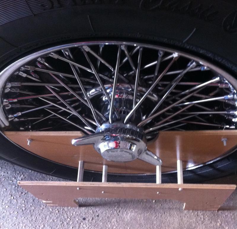

Here's the complex, highly-engineered tool my dad made:

Bob - you got drawings for that tool???

Sorry, the Defense Department made me destroy all documents after we finished the project.

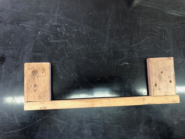

I too used a highly engineered tool such as the one Bob has shown. Although I made it from a piece of aluminium bar and two small blocks. It is designed so that the blocks sit on the inside of the wheel bead thus avoiding the tire bulge. Instead of a typical level held against the aluminium bar to see an angle I used a swinging arm protractor to read the actual degree from vertical.

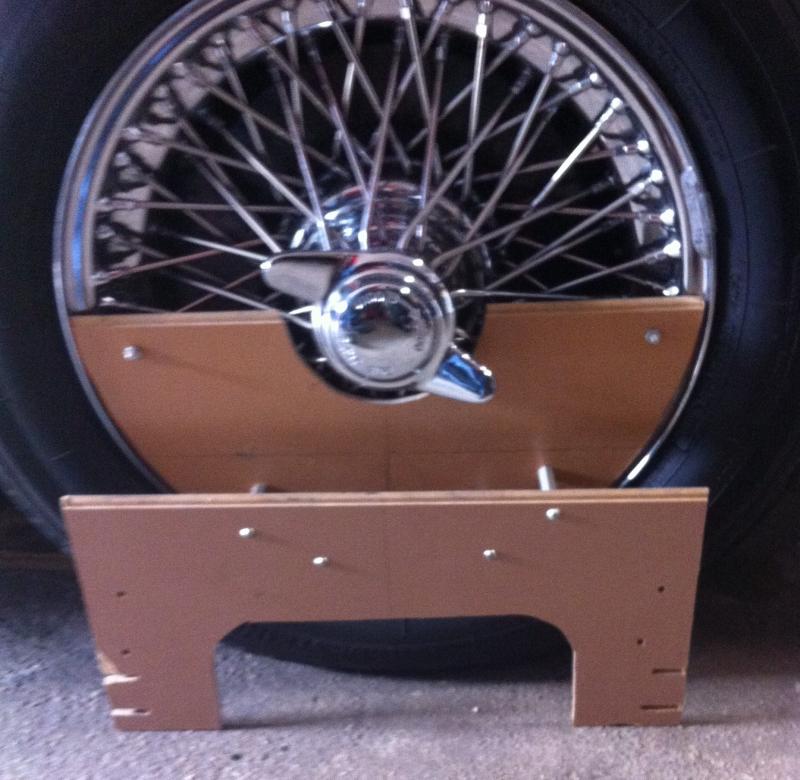

Hi All,
Note.
Originally this post was stated to be able to secure Caster in error and was updated to correctly state the fixtures were designed to secure Toe measurements. Sorry for the original error.
A while back we were discussing wheel alignment and I created a wheel fixture that allowed me to make consistent Toe measurements and camber measurements, The wheel fixtures are held onto the rims with hoods on the spokes to secure their position. In the horizontal position, caster measurements can be taken in front and back of the wheels. Set the fixture extension vertically with a Level, and a O-degree camber setting can be made with the same Level. Each of the 2 fixtures was constructed with scrap material but with the purchase of new hooks.
I used it once and It worked perfectly, to date,

Hi John,
Note: the description below was how the previously posted fixture was used to get consistent Toe measurements and not Caster. Sorry for the error.
Using 2 tape measures, 1 in front and one behind the wheel, placed the 2 tapes through the lower slits, anchored on 1 side (i.e. driver side fixture) and read both at the other (passenger) side after passing through the lower slits on the other fixture. This will give you the 2 measurements needed to determine the Caster.
Keep in mind that the outer portion of the fixture, with the slots, comes close to the ground but does not touch the ground. This results in no interference of the ground and allows it to float with positional dependence only on the wheel. As a result, Caster measurements and adjustments can be made with both wheels in the air, followed by validation of adjustment on the ground.
Although I only used it once, some time later I had the alignment done by a friend with a optical rack and he indicated that no adjustment to Caster was needed. I guess the fixtures worked good.
Ray(64BJ8P1)
