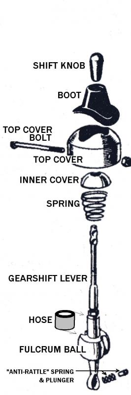

I have a photocopy of Triumph dealers bulletin #T-61-7 dated March 29, 1961 paragraph 4 page 2 Gearshift lever chatter talks about a previous Bulletin covering this topic and goes on to detail the way to fix it. Slide down over the gear shifter leaver a fairly heavy piece of rubber or neoprene tube 7/8" long and 5/8" inside diameter. Press it down until it comes in contact with the fulcrum ball. Reassemble and that is all that is necessary. The rubber or neoprene tube will act as a vibration damper in this position.
Does anyone have a copy of the original Bulletin of a photo of how it looks when fitted.

6TTR3A
I made up a bunch of the rubber "hose" pieces to use as give-aways at
TR events. I included the info from the bulletin and created an
illustration to help with the instructions.
