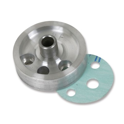

[FONT=&quot]I have a spin-on oil filter adaptor from Moss, part #635-840[/FONT]
[FONT=&quot]I’ve been using the K&N HP-2009 filter.[/FONT]
[FONT=&quot]What filters are others using, and why that over the K&N or vice versa.[/FONT]

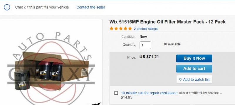

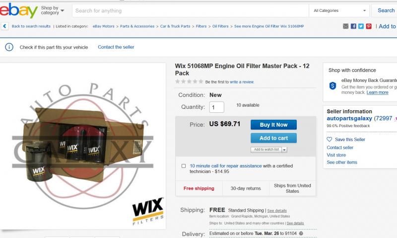

Wix part number is top right of image, in bold ('MP' stands for Master--i.e. 12--Pack). My adapter, when I bought it from Moss, came with a Fram PH3600, which I x-ref'd to these:
Edit: A good thing about this 'Master Pack;'--i.e. a case--is that the filters are individually shrink-wrapped. I just threw away a new but old Mastercraft filter my dad had on the shelf, in the box, for years because there was rust on the bare steel on the business end.
