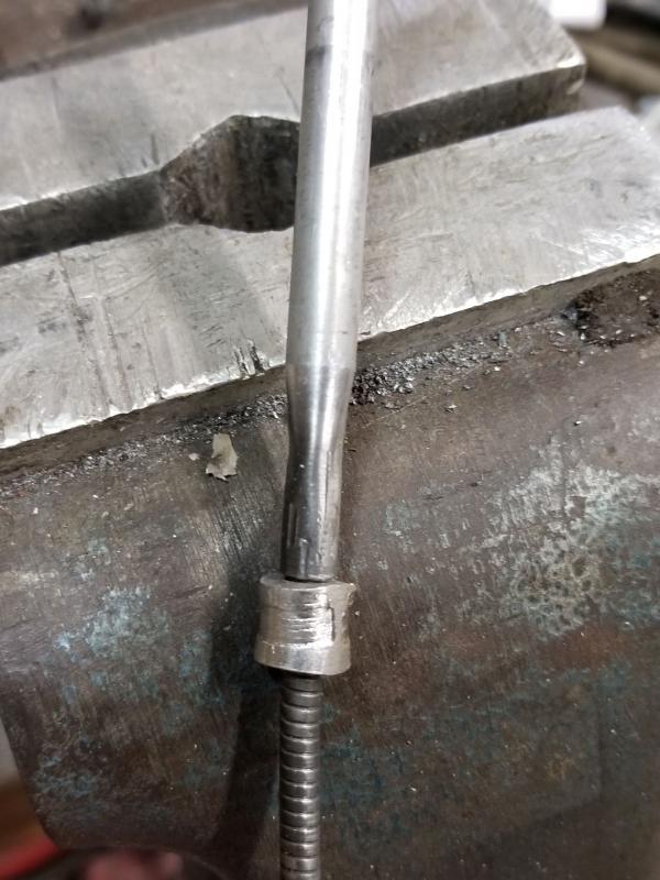

DavidApp
I had a problem with the choke cable not retracting the jets. It turned out to be that the cable outer case was sliding into the part that is secured to the dash. The crimp was not securing the outer part of the cable. It was also a brand new cable all be it bought in 1998 but still in the bag.
As I pulled the choke out I noticed the loop in the cable under the dash would straighten out then return to a loop if I pushed the choke back in.
I crimped a steel cable thimble ob the outer sleeve to stop the outer sliding into the dash part.
Works fine now.
David
