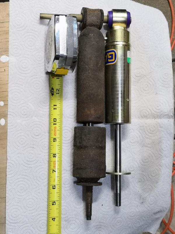

I'm redoing the front suspension on my 3A with a few upgrades. I bought some GAZ shocks, p/n GT2-2272, which are sold for the 3A by multiple vendors. Put one on and when I took the ☼☼☼☼☼☼☼☼ realized that the lower control arm is not touching the rebound bumper. It's my perception that at full droop the arm ought to sit heavily on the bumper but maybe I'm wrong about this?
In any event I compared the new and old shocks. The new one is a good 5/8" shorter than the old one. Photo shows the two shocks at full extension:
I'm assuming this is a bad thing since at full rebound the suspension will bottom out on the shock rather than the bumper. Has anybody else run across this, and what did you do about it? I'm considering modifying the bumper to add maybe 1/4" shim.

I agree, normally it should rest quite firmly against the rebound stop.
Personally, I would return the shock (or pitch it if necessary) for one that fits the application. The 3A suspension has little enough travel as it is, without reducing it even further! 5/8" at the shock is going to be somewhere around 1" at the wheel. Hardly an "upgrade" !

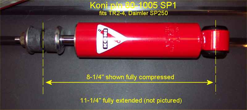

I have Konis on my 3A. I made this before I installed them. Hope this helps.

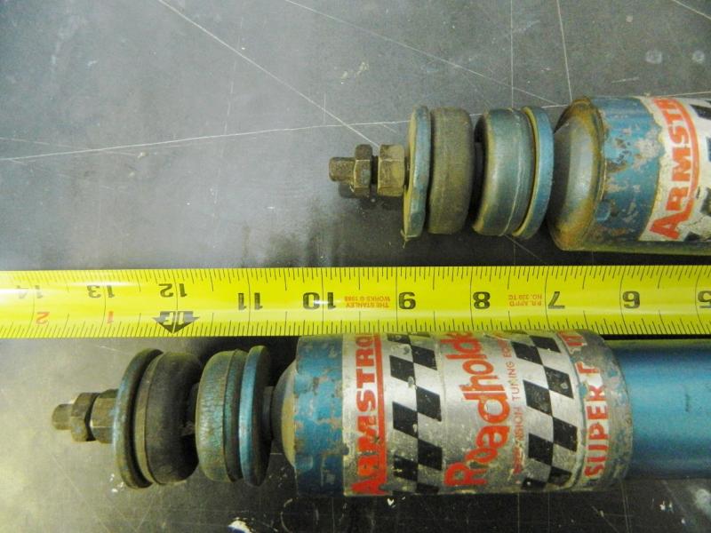

About as close to OE as I have around here from my 63 TR4
