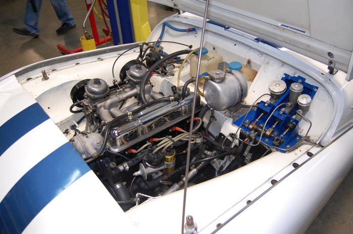

I'm interested in something like the race car pictured below.

Worth noting, perhaps, that with two MCs in tandem like that, the pedal becomes a lot harder. It would be twice, except you can find MCs with a slightly smaller bore.
Also FWIW, if you just split front/rear, you don't gain much. The rear brakes by themselves don't do much, and the TR3 handbrake has no trouble activating them. A diagonal split would give you better brakes if one side fails; but of course is a lot more work to implement.

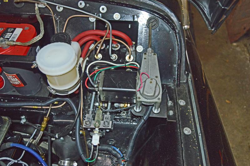

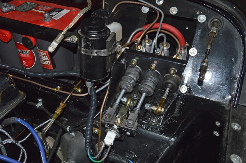

I fabricated a system based pretty much on what Revington is selling. I initially used two 5/8" bore masters in place of the single 3/4" bore single original. The pedal was a little firmer than with the single cylinder. Willwood recently came out with Girling type M/Cs with 1/2" bores. I installed two of those, and the pedal is now actually a bit lighter than with the single 3/4" cylinder. Pedal travel is a bit more, but not enough to be disconcerting. If you buy or put together a system, I would make sure that you use the 1/2" bore cylinders. The original TR3 system is stiff enough, you don't need to make it stiffer. Revington supplies 5/8" cylinders.
I only did it because well, it seemed like a neat project. In the second picture, I changed the dual circuit reservoir. Initially, I used the original can for the dual circuit, but the look of the piece of wood really bothered me. :wink-new:
The reason that they use a dual system on race cars, is so that they can balance the bias front to rear. In the first picture shown, you can see between the two masters is the mechanism that allows you to do that on the fly. I have a balance bar like that, but didn't install it because as it is now, the fronts and the rears pretty much lock up at the same time.

Art, I like what you did and would be up to that project except for the plumbing, especially downstream from the MC's. The kits come with it all (maybe).
