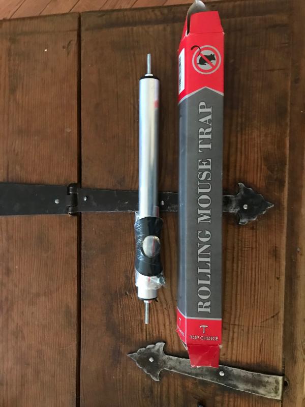

Speaking of mice. This arrived yesterday. Will be trying it out starting today.
The only place they don't work well is in the logging country, those mice can walk a rolling log! :highly_amused:
