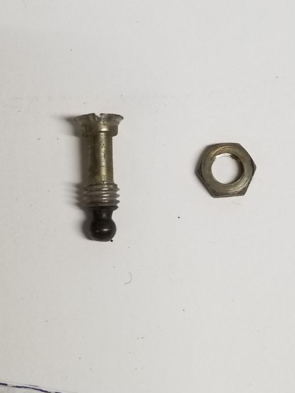

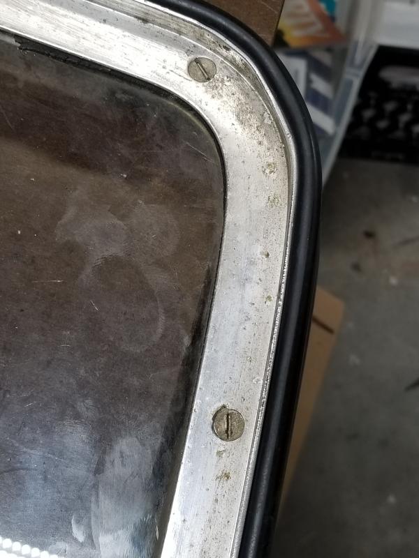

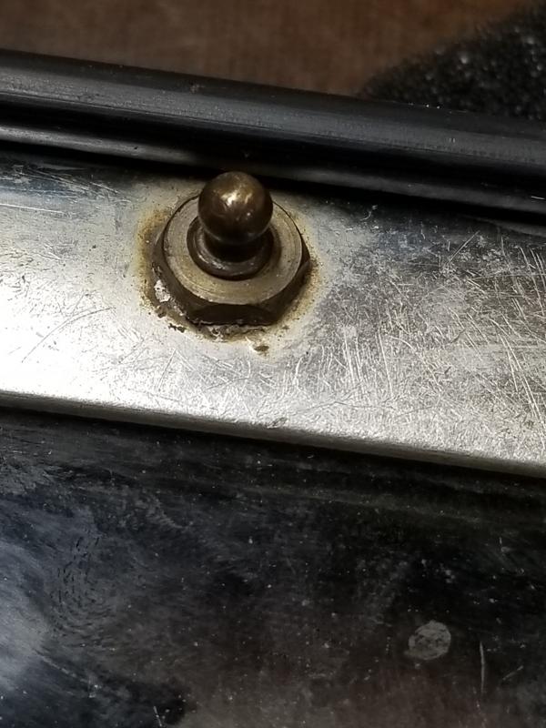

    Looking at my windshield getting it ready for the car. My car came with a spare windshield glass. I notice the one in the frame has a few issues but I will not change it just yet.
    I managed to get the rubber seal along the top of the frame. I noticed the frame has 10 flat head screws(Counter sunk) along the top of the frame. The Tenex studs are made up of 2 parts. Flathead screw with the tenex ball on the end and a lock nut holding the screw in the frame. Is this a known version of Tenex stud?
    The frame appears to be aluminum.
    David

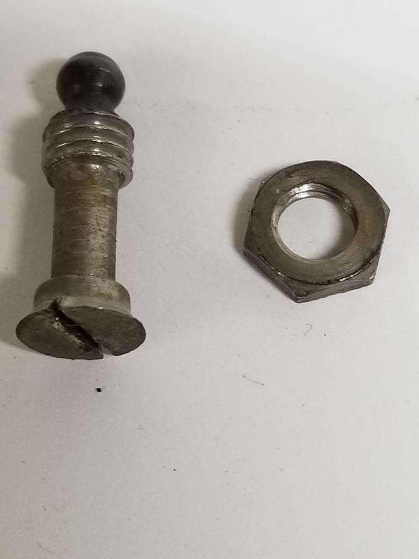

    According to the Bill Piggott book there were some Aluminum Windscreen surrounds on post 60,000 cars but not many as they tended to be less able to stand the force of passengers using the screen as a lever point as they got out.
    The Tenax stud is a strange looking piece and I am in a dilemma as some of mine are showing some wear. Any thoughts on replacements?

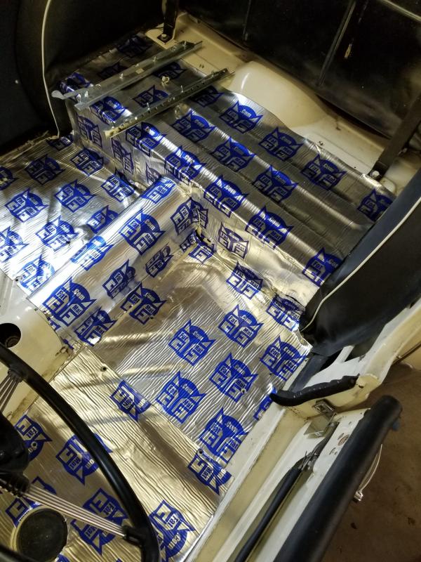

    I have been putting the sound deadening material throughout the car. FatMat.

    I have read about those windshields and that is the first one I have seen. I think it is pretty cool, but finding parts for it heck who knows. Maybe Marv or there are 2 different guys in Canada that sell stuff ; the one guy Len Drake sells on line and has a very large tr3 selection. The other guy is on British Columbia craigslist.

    I e-mailed TRF and Albert replied saying that they have them in stock. I was both pleased and surprised that they had them. Ordered a set along with the corner pieces.
    I always get great service from TRF.

    Looked through their catalog but that was before I had taken the stud out to see what it looked like.
