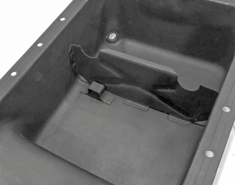

So Im in the process of engine building . I selected my oil pan and proceeded to beat the living bejesus out of the usual dents etc .
After reshaping the pan the spot welds for the divider baffle and the small U shaped piece behind the baffle were broken . Removing the baffle makes reshaping the pan way easier .
Anyways I do intend to refit the baffle as I get what thats for but does anyone know why and what that small inverted U shaped piece is between the baffle and the back wall of the sump that goes up to the shallow collection area ?
The reshaped pan is now sitting on my bench supported on wood blocks full of old waste oil to check for leaks . 2hrs in were all good .
Healey Nut
Healey Nut
Is it to trap sludge?
I dont see how that would work as its open on two opposite sides . My thought is at one time they used to slip a small magnet under it to catch metal material ?
Just a theory .

I also asked the same question back in the early 1970s after pealing back the bottom of my pan when trying to straddle what turned out to be a raised manhole cover and not a deep hole in the highway. The answer I got then from the welder was that the engine had been used on a number of British cars and it was there to support an oil pickup. He also indicated that the baffle was in a different place for the other engine and this knowledge led me to believe he knew what he was talking about. I have no idea how true that is and just dismissed further interest after reinstalling the pan.

Well my overnight test of the sump filled with waste oil worked , shes leak free . So Im going to put the baffle back in and forget the little U piece . Dont think the concourse guys will ever know :encouragement:.

I'm sorry, I don't buy that support for oil pickup thing.
I've seen most of the original C series applications from 2.6- 2.9, eg Austin /Wolseley/ Morris and haven't seen any sign of an oil pickup support at this location.
The oil pump changed from a four bolt to a three bolt fixing early in production (2.6) but didn't change the pickup location AFAIK.
All the original sumps from Austin A90/Wolseley 6/90 (the first C engined cars) to the Healey 3000 were AEC 203.
Then again I have been known to be completely wrong once or twice.

Whatever it is, the bracket is also present in this NOS A90 oil pan:

With your broad exposure to the many multi-marque that use the engine, have you any idea of or actual knowledge as to what this part was installed for? Since I never needed it, I really accepted the explanation given me without a need to question and, I must admit, only have a passing interest now.
