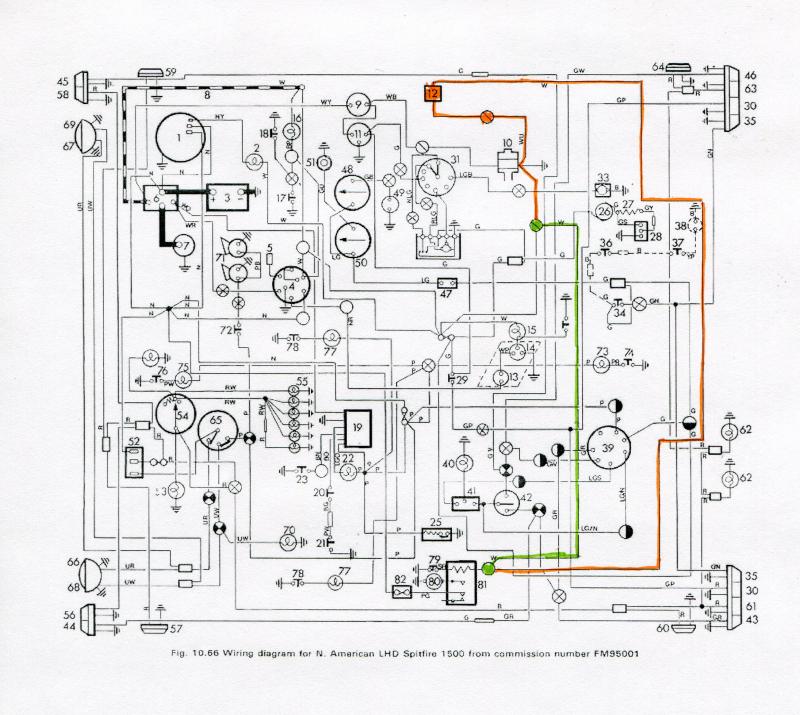

Thank you for your reply, but I'm still a bit confused.
I get what you are saying for the first three wires, and that all makes sense. And the instructions you included on how to tell which terminal is which on the Fan Relay is spot on. But I'm really confused by that fourth wire, the white one (or ones). I was already using the schematic you included. It's from Haynes, which I've included below.
I've highlighted all the wires going to the Fan Relay in green, mostly because I don't have a brown highlighter, and a white highlighter would be pointless. There's no problem with locating the brown wire (the one to the left) or adding an in-line fuse.
But notice how the white wire (to the right) immediately "splits" after it leaves the Fan Relay, there at that circle (whatever that is, which I've circled in pink).

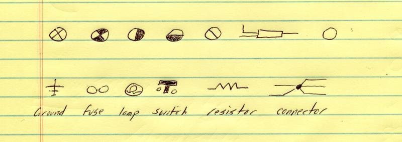

One white wire goes up to a circle with a backslash in it (once again, whatever that symbol means, circled in purple), and from there "splits," with one wire heading to what appears to be a fuse (circled in orange), and the other going to the distributor.
The other white wire goes straight to the drive resistor, and from the drive resistor, after passing through another of those circles with a backslash in it, also to the distributor.
Currently I have no drive resistor on my car, but getting one wouldn't be a problem, and I could wire the whole thing pretty much as it appears on schematic. Should I? As well, I can't find a solid source on-line that explains those symbols worth a hoot, especially relative to my Spitfire. I've attached below those symbols I think I've figured out (bottom row), and those I haven't (top row). I'd appreciate any help I can get on those.
And, finally, though moving away from the radiator fan, the schematic shows a ballast resistor wire, but no ballast resistor. There was a ballast resistor with my car, though not attached (which means it may not even go to it). However, I checked the starting coil with a voltage meter, and it indicates that I need a ballast resistor, so I put it on (the ballast resistor reads "good," too). It goes from the starter solenoid to the coil. The green wire was already there, with one end on the solenoid and the other on the coil, but it was cut in-between, which is why I thought the ballast resistor went where that "cut" was. Does that sound right?

I believe the larger circles with the funny patterns refer to multi-way connectors, with the pattern indicating which connector. One of my Stag manuals at home has a legend (for the Stag diagram of course), which says things like "multi-way located at base of steering column". Each instance of a circle with the same pattern indicates a pair of pins (one male, one female) in the connector.
But a lot of information like that was simply deleted from the later manuals, instead of being updated to reflect the wiring changes. That may be why the Haynes doesn't have it, it wasn't in the factory material that they copied.
The other symbol in your top row I believe represents a 4-way bullet sleeve with only 3 wires inserted. The sleeve connects all 4 openings together, but the 4th opening is left open. Sometimes, you'll see 2 wires (for a 2-way sleeve) or 4 wires.
The white wire is just daisy-chained at the empty round circle (probably two wires crimped into the same pin on the multi-way). The significant path, from the relay point of view, goes up to the circle with the backslash, then down to a small circle (which I believe represents wires joined directly together, often inside the harness) then back up to an open large circle and then down to the switch. When the switch is in 'Run' or 'Start', it supplies power to that terminal from the brown wire that goes down to another open large circle, and off to join with a bunch of other brown wires (including one from the hot terminal on the starter solenoid).

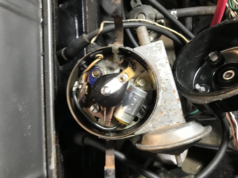

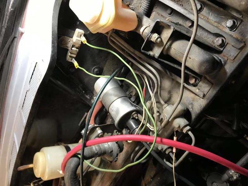

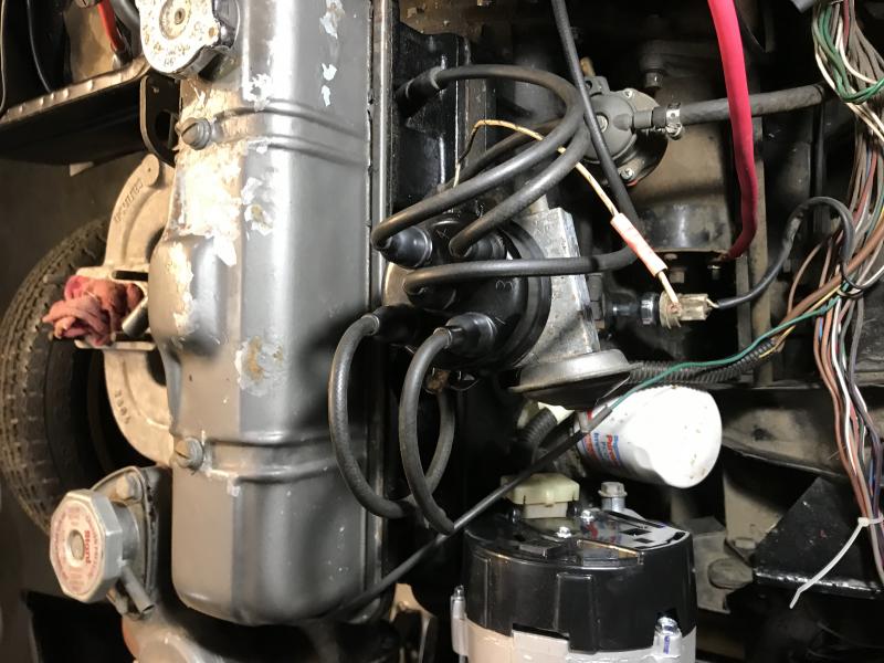

I'm assuming I have an earlier distributor and points, but I may not. I've attached a couple of pictures of my distributor here. The first one shows the outside, including that wire that goes nowhere. It appears to be WB, but it's hard to tell, even in person (it could be WU). The second shows the inside. What is that cylindrical thing with the black wire that connects to the WU / WB wire? Is that an electronic ignition module? If it is, what does that change?
So let me see if I've got this right. As things stand now I don't need the ballast resistor at all, going from the solenoid to the coil. Do I still need that orange wire that runs between the solenoid and the coil, only without the ballast resistor? Would it matter if I just left the ballast resistor there?
From the Fan Relay, I only need one wire, the white one (which I've highlighted in green below), and all those wires that are highlighted in orange, as well as the drive resistor, are not necessary at all.
When you say to connect the WB wire to the side terminal, what do you mean by "side terminal"?
Thanks for all your help. The wiring diagrams are a bit abstract, at best, and the parts catalogs only show the parts, but not where their wires go (if they give any instructions at all), so it all can be very confusing for those of us who have never done this before. Once again, thanks.

My apologies, I expected there to be a terminal where the wire sticks out if the distributor. My bad. Ignore what I said about the terminal, and connect the WB to the coil.
Those are points, the round thing is known as the condenser and it is essential when using points.
Yes, the wires in orange are not needed when running points.

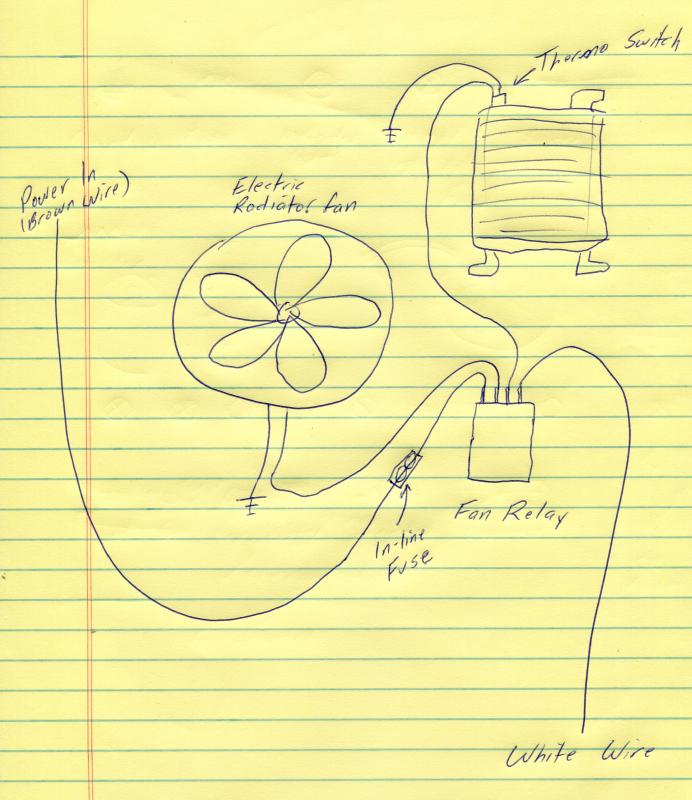

I think I got this right...
There are four male electrical connections on the Electrical Radiator Fan Relay. There is one connector each for the four following leads:
1) Power for the fan motor – a brown wire, which is unswitched and unfused power. There is an in-line fuse. The wire from that fuse to the relay is purple with green (or not, being that there is no wire). These wires are hot whether the key is on or not.
2) The Thermo Switch, which is connected to the top of the Radiator and tells the Fan Relay when to turn on the Radiator Fan.
3) The Electric Radiator Fan. It carries the signal from the switch to the fan.
4) Any white wire, which is hot whenever the ignition is on.
I can figure out which wire goes where on the Relay using the advice you gave me on a previous post. Here's a really bad picture, but it's how I'm seeing it:
As well, I need to lose the orange wire completely, along with the ballast resistor, and not to worry about not having a drive resistor. And the wire that's coming out of the distributor needs to go tho the coil. Does it matter where on the coil?

Looks good.
On the coil, it doesn't make a lot of difference, but it does make a little. So it's best to connect the wire from the points to the terminal marked with "-".
The other terminal "+" gets power from the ignition switch (through the resistance wire).
