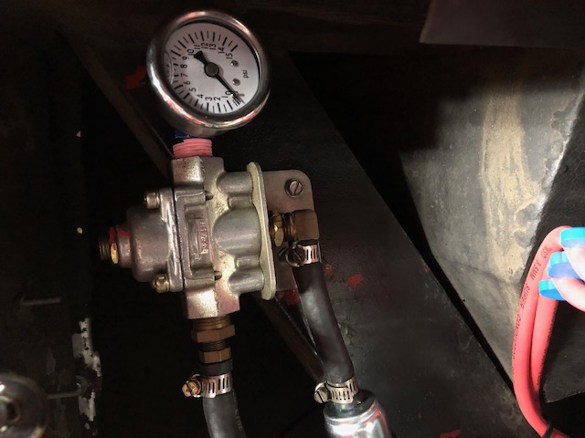

My engine is set up with a fuel pressure regulator, but it didn't have a pressure gauge. I wanted to see what my fuel pressure is so I bought a gauge and installed it on the regulator. With the key in the on position the fuel pump turns on but I'm not seeing any pressure at the gauge?? How can this be?(engine runs fine) Shouldn't I see pressure at the gauge with the key on? I didn't start the engine today to see if there was any difference, raining today. This is on a Chevy 350.

I'm assuming your gage has a range of something like 0 to 10 psi and you are not using a 500 psi gage that might not be sensitive enough.
Does your regulator have more than one port that can take a gage? Be sure your gage is on the down stream side of the regulator. Other than that I have nothing. It is possible that your fuel pressure is low but high enough to keep the float bowls full when running.

Here’s a pic of how it’s installed. It’s possible it’s set too low to read.

If the regulator is cranked all the way closed your fuel pump may still run continuously depending upon what kind it is as some of the Facets hammer on regardless of whether or not the engine is running. In any case you should set your fuel pressure regulator up with the engine running and at different rpm's. If at that point you have no indicated pressure you might have a bad gauge.

I have a similar regulator setup with a Facet gold box pump. When the float bowls are full, the pump keeps running, but zero pressure shows on the gauge.
I was loosening the 4 screws to bleed the pressure out, then starting the pump again to display the approximately 2 psi the regulator is set at. I could then take the car for a drive, during which no fuel problems, then observe the gauge displaying zero pressure like the picture above.
I then timed 60 sec of flow into a gallon can and observed 27 gph (18 gph needed for BJ8).
Gave up worrying about it as everything seems to be working properly and I've driven it 30 miles since then.

Most float needle valves can only hold back up to about 7 lbs. Anything more than that is a good chance of pushing past the needle valves. That includes and American down draft carb or an English SU. Typical early, old school carbs operate on about 4 lbs.
If fuel is weeping past the needle valves you might not see any pressure on a gauge.
