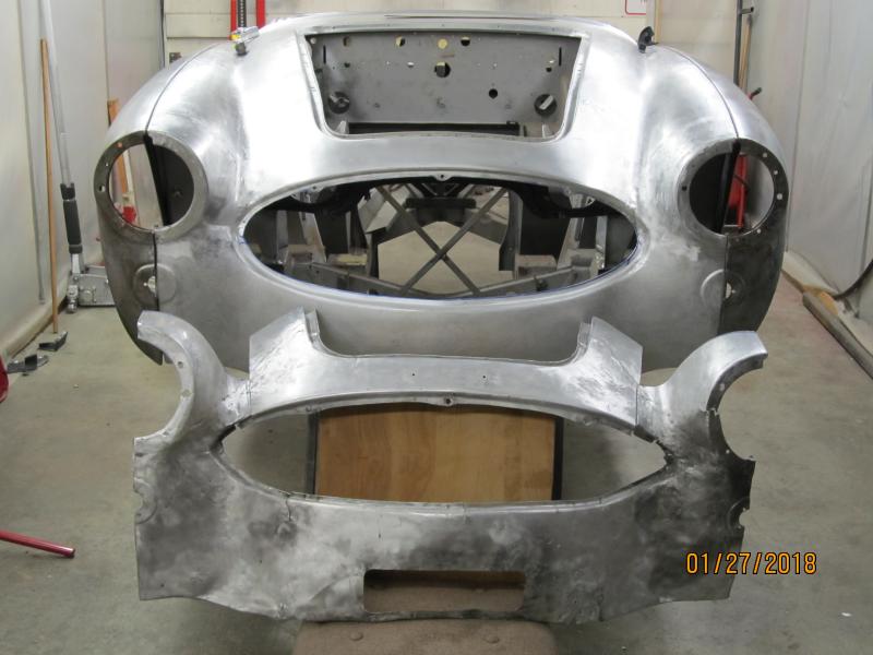

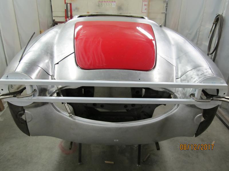

Hi Martec. I'm 5 years in with mine working on it evenings and weekends here and there. It has been a steep learning curve but I am still enjoying the challenges.
I have welded steel for years but never aluminum. I tried oxy/fuel welding first and spent most of a winter practicing but never got to where I would trust my welds on the shroud - too high a percentage cracked during post-weld cooling and I never really got a handle on it so I bought a TIG machine. I spent another winter practicing and reading all I could about TIG welding and finally got to where I decided to go for it.
I'm not going to bash any suppliers but if you need to replace any panels, be prepared to examine them very carefully to see if they will really work. I bought several shroud pieces that, at first glance looked good but ended up not really useable. An example is the piece between the bonnet opening and the top of the grille - the overall shape was good and would have worked great, but the channel shape around the bonnet opening was 3/16" too deep and 1/4" too wide and could not be matched to the existing channel. I ended up searching out NOS body repair pieces over about 3 years. The NOS pieces I found fit perfectly with no odd issues.
Vette does make a good point about cracks - I haven't gotten mine together yet to see how many cracks it develops but I won't be surprised if some show up.
An irony is that I just finished my front shroud last spring and over the last 3 months I've seen 3 for sale within 100 miles for less than $1k - they all looked like they would need some minor repair but nothing at all like mine needed. If I add up the welder, the consumables, the repair pieces I bought, I'm way in the hole but I enjoy the journey and being able to say I did it.
If you do proceed, feel free to pm me. I have lots of pictures of mine step-by-step and the jig I madeIMG_0376.jpg.

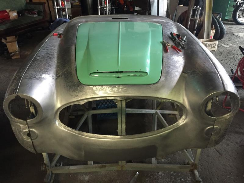

The smooth hood is something I made about 25 years ago.
My first two Healeys were 100s I bought and sold in the early to mid 70's (when they were $500 cars) but I fell in love with the early 'pure design' cars. Then I played with Harleys for 10 years but always wanted another Healey.
Fast forward to the 1986 and I was finally ready to get another Healey but the 100s were too pricey so I settled for my 100-6 from a friend for $2500.
I never liked the hood scoop on the 6 cylinder cars - far as I could tell the only reason for it was so they could shove the radiator forward to get the 6 in. But, in my opinion, the smooth hood/nose of the 100 is what was originally intended (and I think more elegant).
So, I had a local radiator shop make a custom top tank (in a wedge shape as viewed from the side) so that none of the radiator is above the hood opening in the shroud. I had a mangled hood from a 3000 that had hit a deer and this was the source of the doner radiator (top tank destroyed but bottom tank fine) and the hood hinge and latch inner pieces. So I made this hood out of fiberglass bonded to the stock inner panels and some metal framing. At the same time I installed a 100 windshield because I consider that to be the most incredible, signature piece of a Healey and I love wind in the face. So, it's a wanna-be 100 with 4 seats and a 6.
Funny thing is that when I started racing in 1997 the SOVREN rules were very specific, unless you could document a history in the day as a 'modified' car, you had to comply with SCCA PCS (production car specifications) which did not allow any 'modification to factory bodywork'.... Generally meaning things like wide fender flares or other alterations resulting in more speed (Smokey Unick's Camaro with the smaller nose/frontal area comes to mind). So I sweated bullets worrying that they would not allow my hood. Seventeen years I raced with SOVREN and no one ever noticed the hood. The windshield has been a great feature for me because it is so easily removed at the track (I drove to & from the track like the old days - the small Perspex shield is permanently mounted and does not interfere with the 100 shield).
Dave
